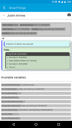

Can anyone assist me with setting up a piston to flash a certain color based on a trigger?
I’ve tried setting the color first and then running the flash condition but it reverts back to the soft white color while flashing.
Thanks in advance!
Post a dashboard screenshot of what you have so far
Here you go!
Add a Wait 15 seconds between the Flash and the Set color to “Soft White”. Flash takes almost 15 seconds, but the soft white happens right after flash starts, not after it ends.
@AlmostTan Yeah, what he said! Lol
Thanks so much, you are a god among mortals… Worked perfectly.
@bamarayne you too buddy, thanks!!
