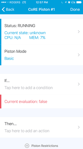

We’re do you type that in? In the mobile app smart app section?
[image1.PNG]

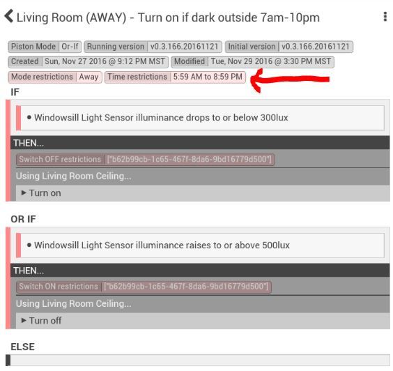

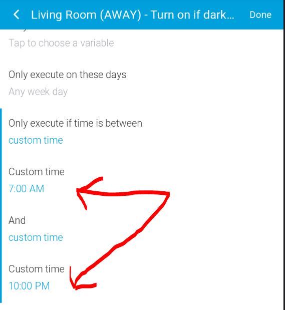

Screenshots of a time restriction as created in CoRE and as it appears in the Dashboard. Why the 1-hour difference, and what time will this actually be able to run? (Actually, last night the offset changed to 1:01, as seen here - before that, it was exactly an hour.)
Check your PC time… just a guess.

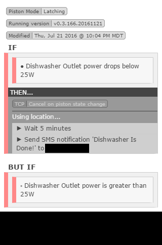

Do you have a graph of power consumption during a full cycle? Anything particular during the last power surge before the cycle ends? Thinking about a certain power level/length to watch for before waiting for the low power mode. Use a latching piston to make it all work and voila… depends on your graph though…

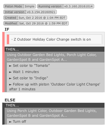

hello all, I am very new to core, and I’m having an issue. I set up 2 pistons (below). however, xmas worked for about 60 seconds, not properly, and now it’s stacked on red. 2nd piston (Hue xmas) is not working at all.
any advice?
Put the follow up piston direction in line with the rest of the directions.
I have one that does some thing similar, just using a switch not time.
Also SmartThings can get upset if too many commands are sent over 20 seconds, normally for something to change the minimum should be 30 seconds.
