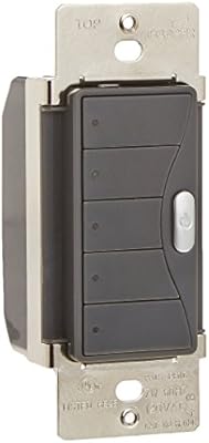

My house has Cooper light switches and I’ve replaced a number of them with their Z-Wave switches. I’d like to buy something with multiple buttons such that I can set different functions to each button. Cooper has the device below, but I’m curious if I’d be able to assign each button to a different function (e.g. disarm SHM, turn off a couple remote lights, close the garage, etc.).

  1. it sends a message directly to the light. The hub doesn’t even know it was sent. In this case, the two devices must use exactly the same protocol and must be within One hop of each other.
The Cooper 5 button switch is this type of Z wave device, as are most devices labeled “scene controller.”
