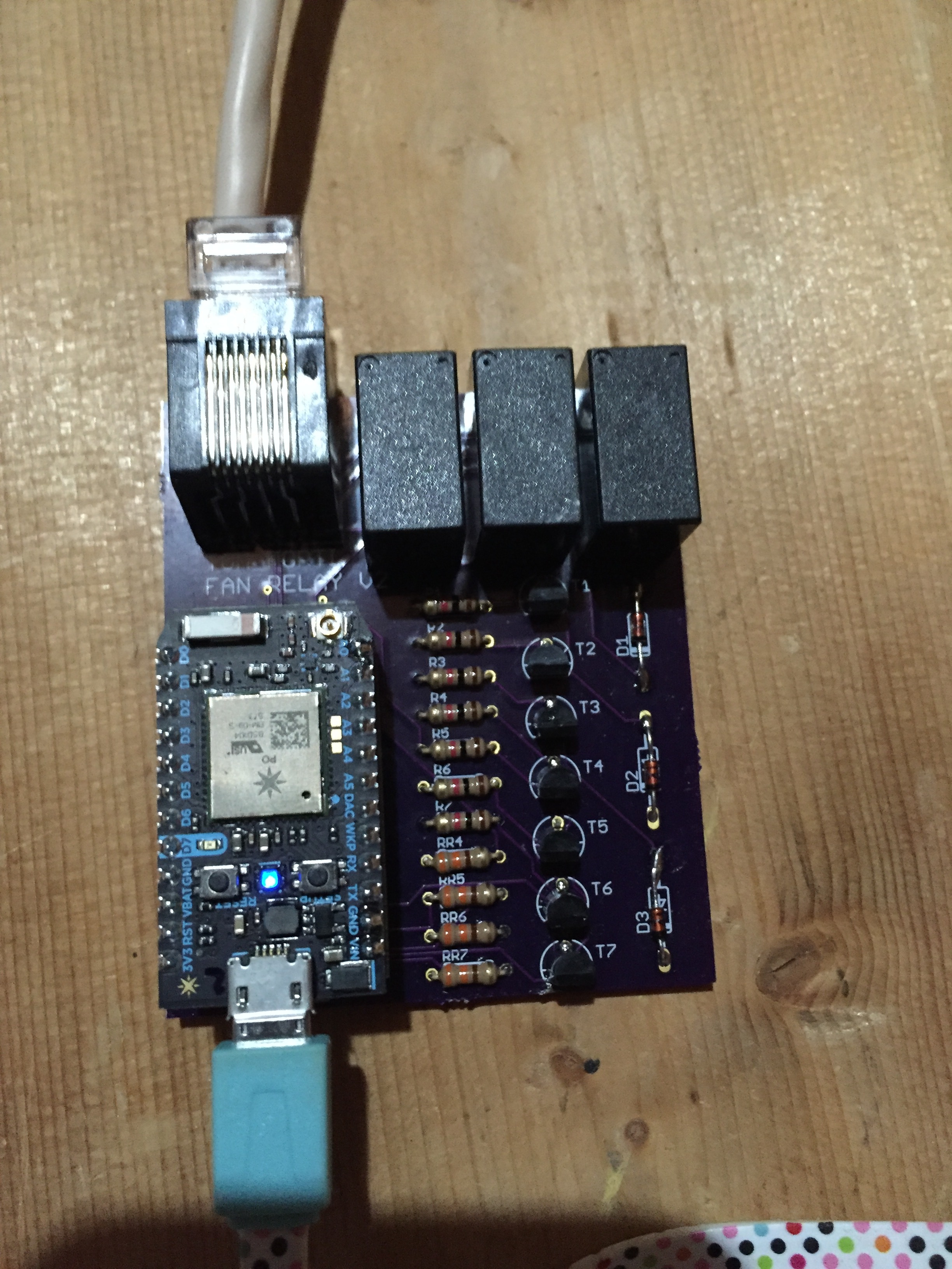

Wanted to share. This is my git code and eagle file for my project. I have a Photon on the eagle board with a Cat5 cable connected to my Hampton Bay Controller. Enjoy
Cool, any pictures?
Sure do.
If anyone is wondering why I am using relays its because this could be done using transistors only. Here’s why. When I installed my fans back in 2014 I for some reason put all the code pins on for fan 0, pin 1 off and 2-4 on for fan 1 and so on. So I had to use a relay that is Normaly Closed. So when it was triggered it was actually opening the circurt. It was a decision on if I wanted to just use relays on my board or pull down the fans. You can guess what won.

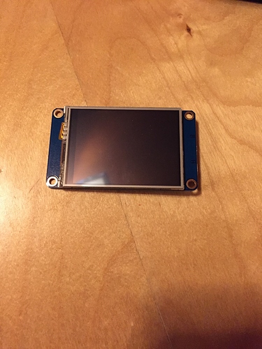

This has been working good for a while. I just change the battery every so often and I’m good. My next project I want to do with a photon is connected to a Nextion display connected to a photon placed within an electrical box. With my new Ecovent system I want to have a display to send API commands to smartthings, to control the lights and fans, and also control the Ecovent room temps. It would be a decent project if I can figure it out. The photon is $20 and the Nextion is $10. Most of my projects I make working off of others projects to learn the code. Right now there’s no one who wrote a project that uses the Nextion with a photon and also no projects that send commands to smartthings from a photon. Just sending commands from smartthings to photon. If anyone knows any code let me know and I’ll get working.
Wow very neat. Never thought of using Cat 6 like that… This is your own board design? How did you find that experience? Or are you a seasoned vet when it comes to custom pcb…
My design was based on a project from a particle post. https://community.particle.io/t/ceiling-fan-controller/6170?redirected=true I’m actually a nurse, everything I learned was from this community, partial.io community and GIT. Eagle software is free and super easy to use. I watched 2 or 3 YouTube videos on how to use eagle and was set. Sites like spark fun has a zip download for eagle of all their parts too so that makes things easy. You start out making your schematic than arrange the parts on the board, allow the program to make the wire tracing automatically. Than head over to oshpark and upload your eagle file. Depending on your board size 3 boards will cost you $30.
