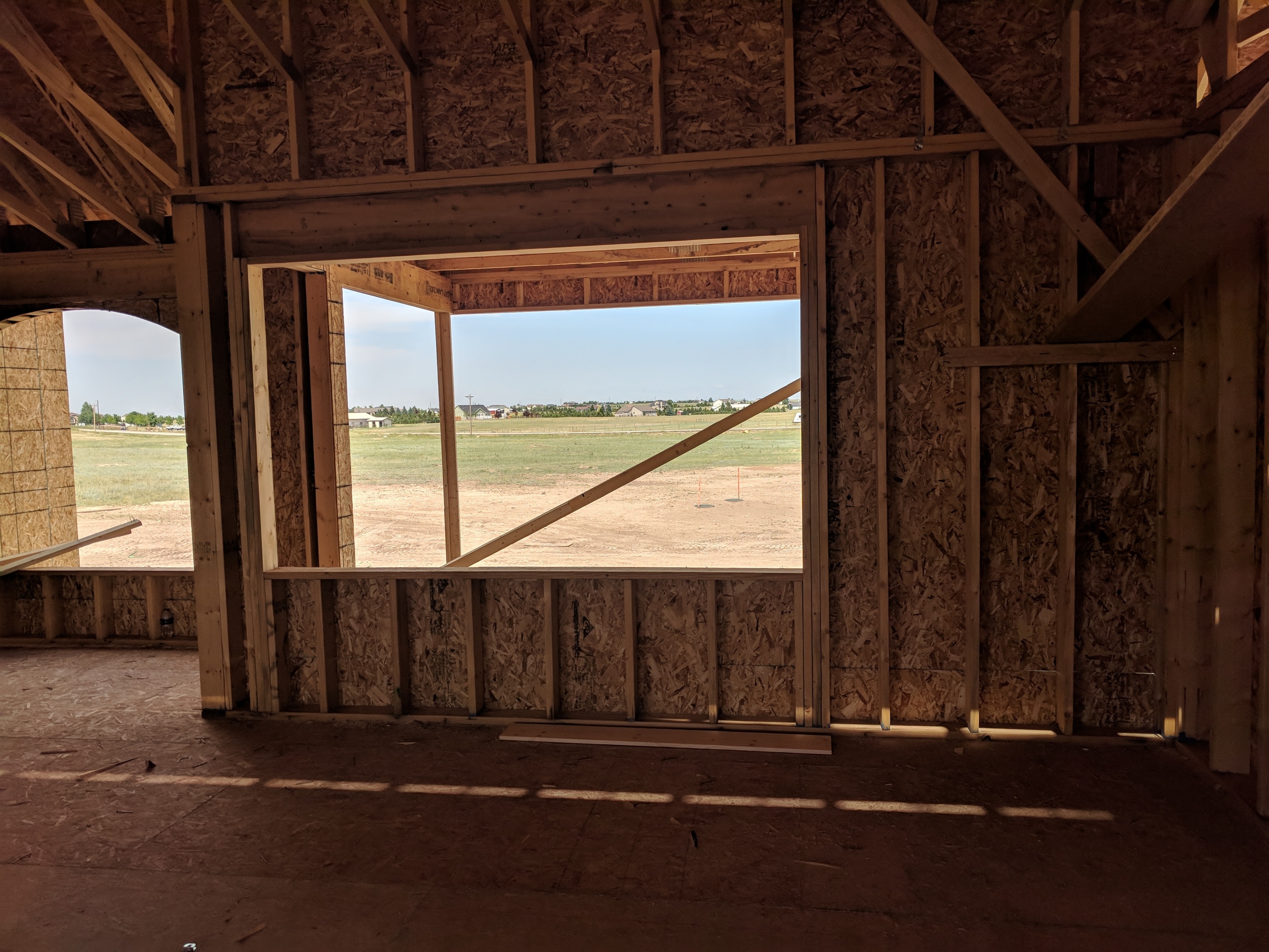

Well, the house frame is up, and it’s getting closer to electrical time. Any recommendations for wiring for the low voltage to the windows?
