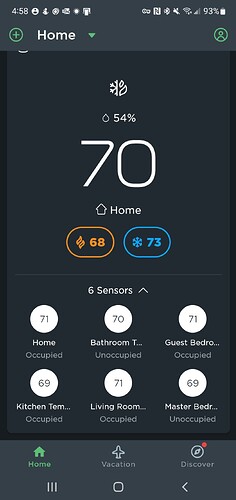

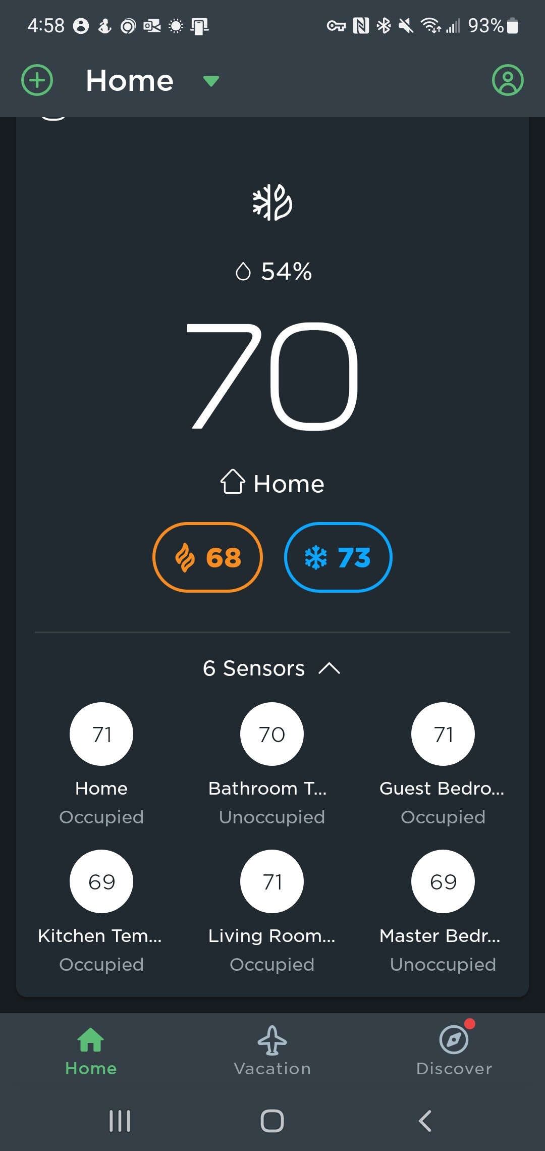

I don’t know if you’ve considered using an Ecobee Thermostat or not, but it has separate temperature sensors that can be deployed into different locations and then used by the primary thermostat to maintain the set temperature for that location based on occupancy and comfort mode settings (like Home/Away/Sleep/etc). That way each sensor location can trigger the heating without having to use ST Routines.
