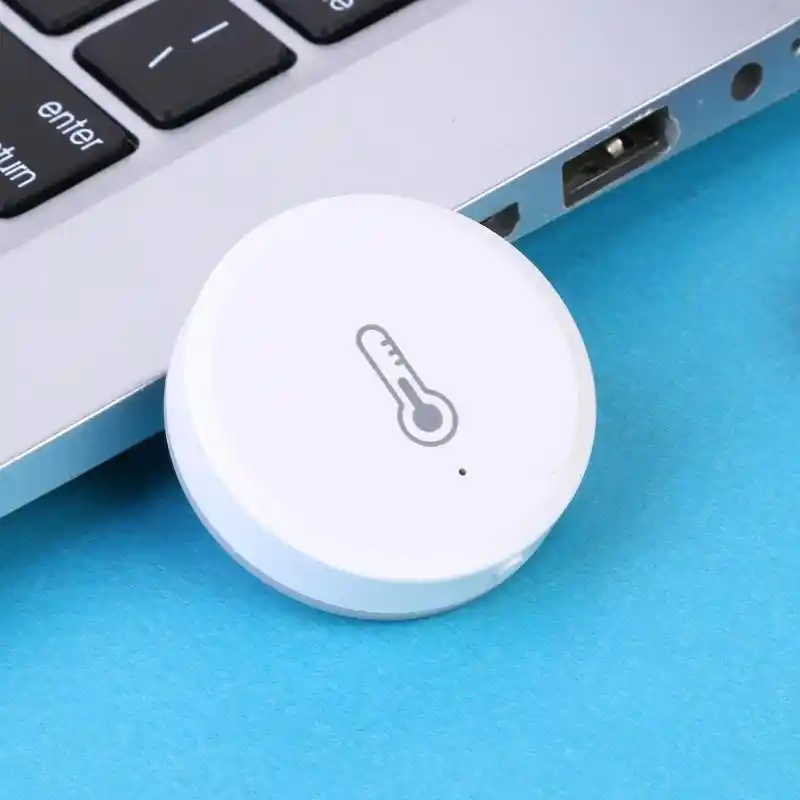

I have a Tuya ZigBee 3.0 humidity/temperature sensor. I can pair it with SmartThings, but nothing else - I can’t get any reading from it.
I thought that ZigBee 3.0 certification would ensure a seamless integration with no headaches, much as with Z-Wave and instead I’m wrong, apparently. Very disappointing.

What was the page? That would be helpful to know whether someone misrepresented it. The new ones supposedly look like this. (a flatter version of the Xiaomi sensor, if the image is to believed)
