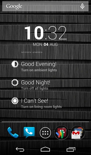

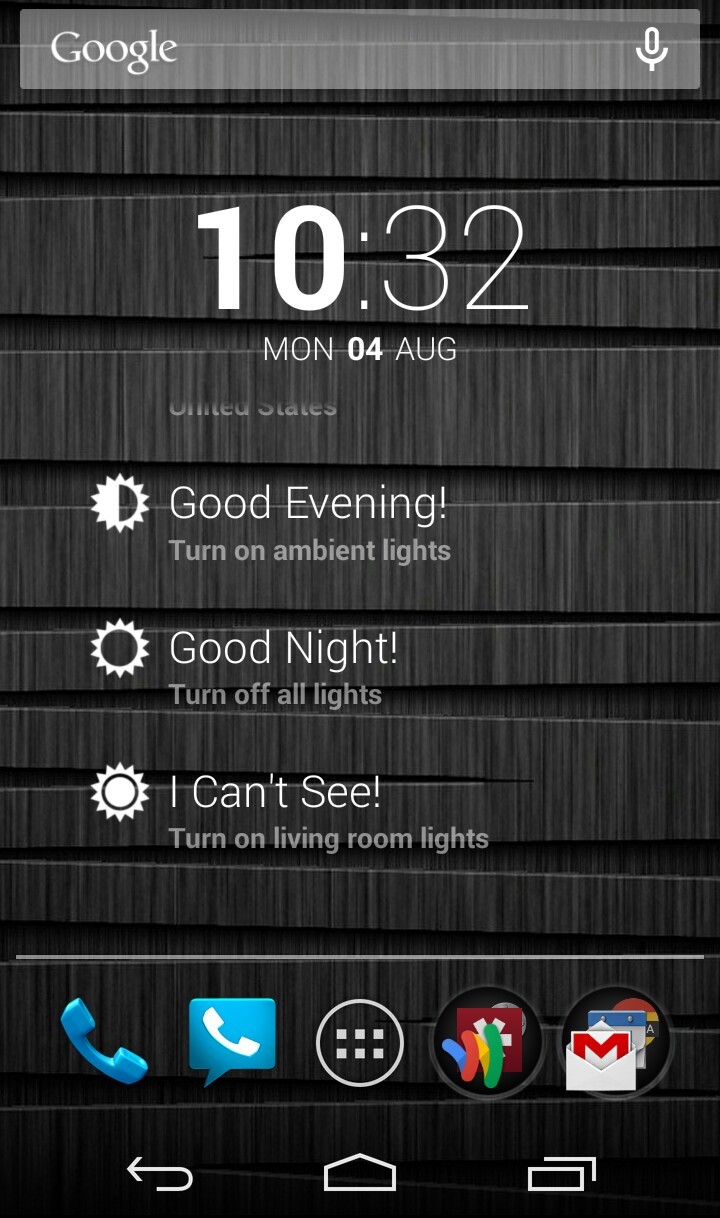

I is it as an intermediary with Tasker for my Android app. Instead of mucking around with Oauth2 and the like, I just have Tasker send a text message to IFTTT tagged with what I want it to do.
My complete setup includes DashClock Widget -> DashClock Tasker Extension -> Tasker -> text message -> IFTTT -> SmartThings.
I also dynamically add and remove the DashClock extension from the widget using Tadker depending if I am connected to my router or not.
