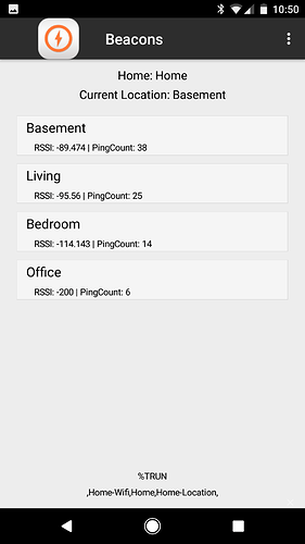

How this works, uses Autolocation and wifi connected to determine if you are home. Basically the same as this post This will then set a smartthings presence sensor “User Home” to present. Once the user is home the app will wait for you to walk, once you start walking it will scan for beacons. The beacon radar app reports every ping back to tasker. Tasker will not scan continuously while walking, but every few seconds. Auto tools will then average all of the pings to determine the average RSSI (recieved signal strength indicator). Whichever Beacon’s avg rssi is closest and with the most number of pings is the location. Once you stop moving this will continue to scan for several seconds. when a new beacon is selected as the Location the presence sensor for “User BeaconName” will be set to present and all others will be not present.

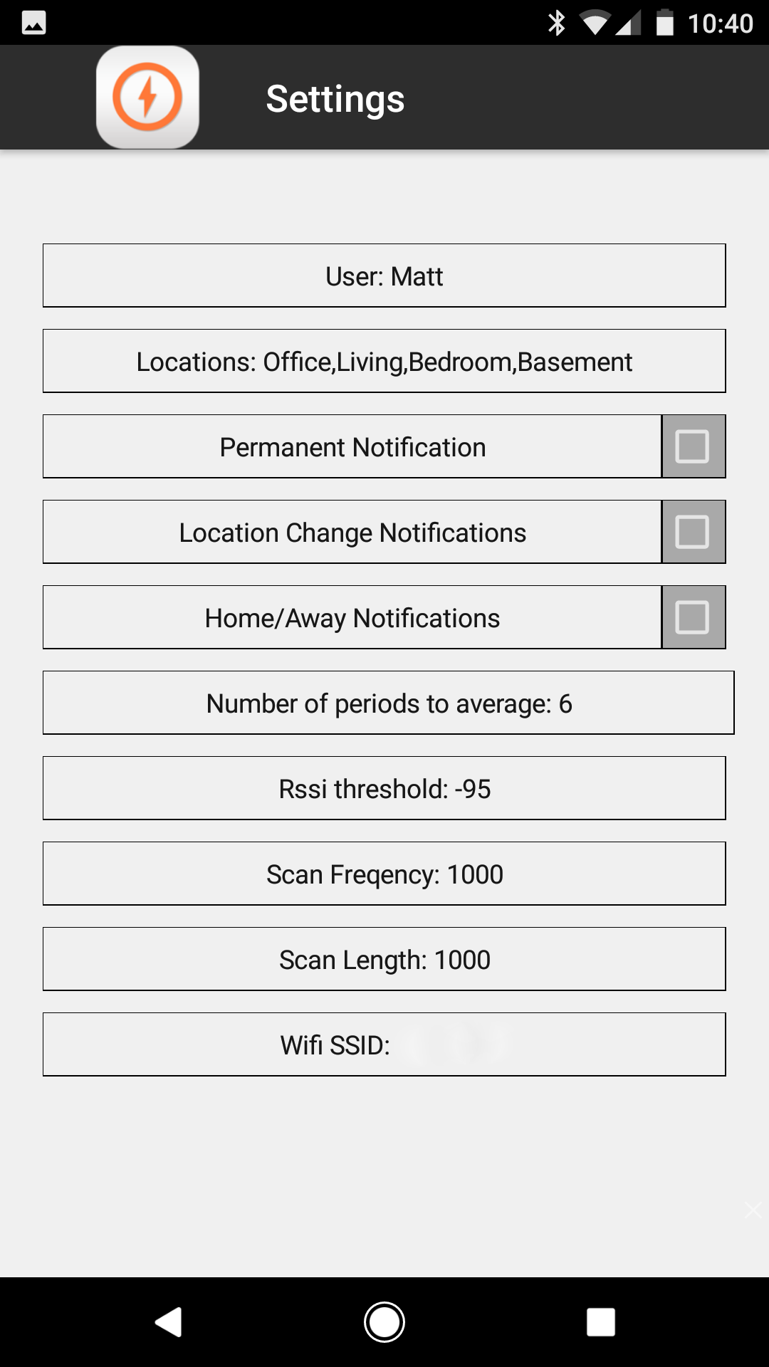

  • Enter the user for the app
  • Enter the wifi for your home
  • Enter the Locations - this must match exactly the name of the beacons you setup in beacon radar, if you have multiple separate by comma.
  • Thats it - you may want to scan now to set your current room, or get up and walk and few steps…

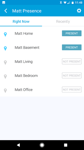

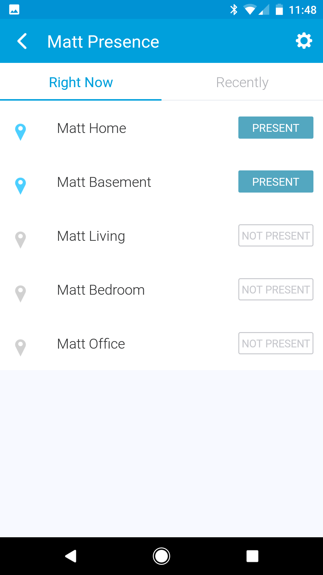

The end result should look like this:
