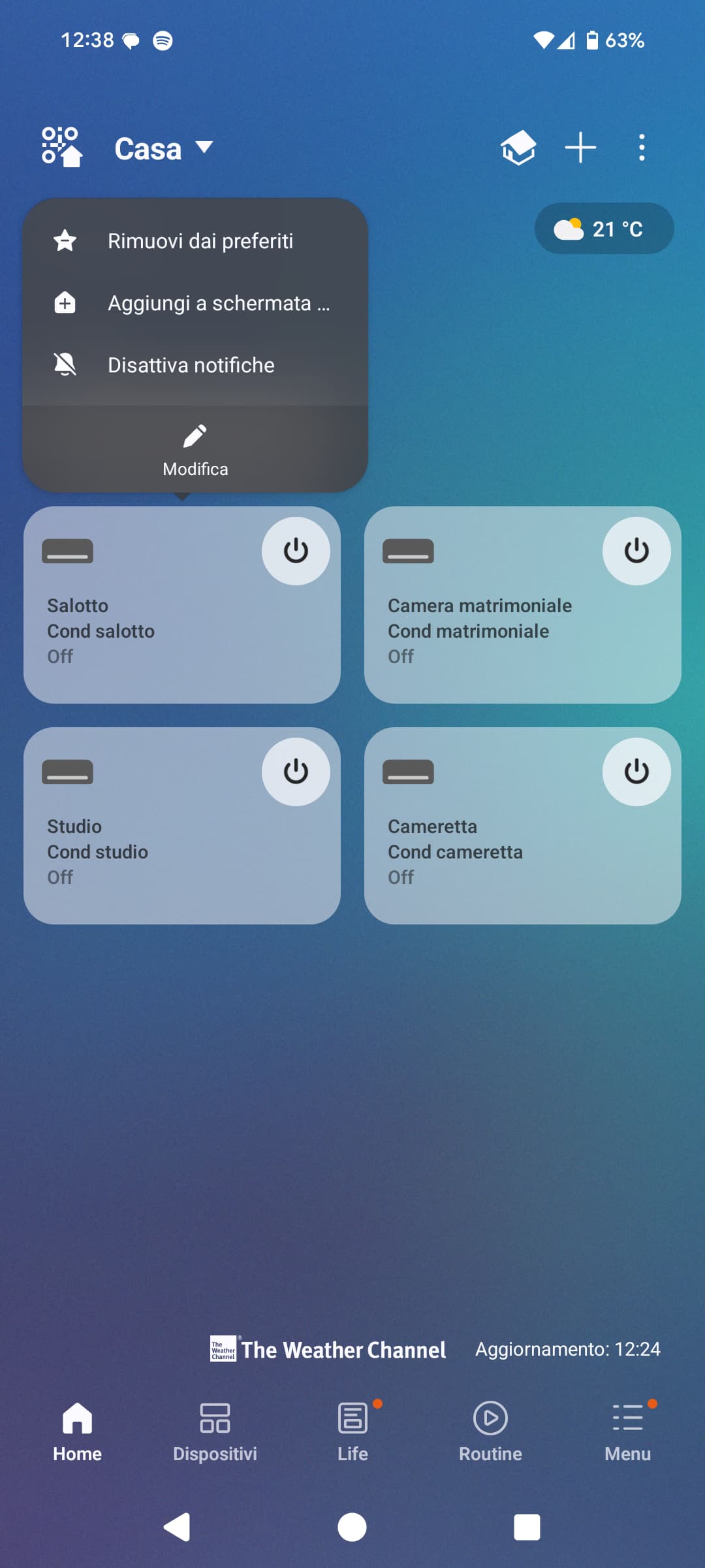

How can I remove the device?
From “devices” page I can only “add to favorite”, add to home, edit, disable notification…
No way to delete it from my profile without entering device detail page…but it’s not loading…
So I cannot remove the device…

Hold press on device
No so easy man :frowning:

That’s what you see from the Favourites icons on the Home tab. If you go to the Devices tab you should see the extra remove option when you hold a device icon. Alternatively go to the three dot menu on the top right of the Devices tab and choose Manage devices.
You are right.
