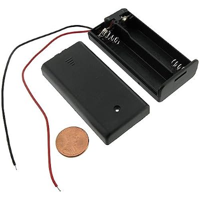

Like everyone else I have noticed right away the poor battery life. I must say that after 3rd pill battery installed, I have noticed that battery life was a bit improved. It got to 15% very fast, but then stayed at 15% for a long time. Not wanting to deal with battery/reliability issues, I hacked it. I see that similar hack was already suggested, but here is mine simple solution:
This holder has 2 AA batteries supplying total of 3V needed for the power. Just connect (I soldered) two wires to the contacts, attach sensor case to the battery case (I glued mine together) and you’re done. Very fast, cheap and simple fix to the issue.

Nope, no $$$ to be made. The hack has been done many times, and in fact is doable in a 4-AA case where you house the sensor right in the case with two batteries. A guy called Cobra on this forum showed that hack, and it’s what I’m using. Put it together a couple weeks ago when I too tired of the unreliability of the phone-as-presence option.

You make a pertinent point. I converted the Arrival Sensor with two AA batteries for the car, I can’t imagine people changing those coin cell batteries out every few months. Not sure about putting it in a 4 AA battery box, as that would effect the range. Seeing as SmartThings aren’t doing anything about it, I think there should be a page on here where you can buy these ST hacks from people, who already do the hard work, work out the voltages, do the soldering. And put Xbee’s together also for people is another thing.
Taking the sensor out of its plastic housing, next to a battery, and putting it in a different plastic housing next to a battery should not affect its range at all. Hypothetically speaking, that is lol
I will say that the range of mine has increased since doing the mod.
