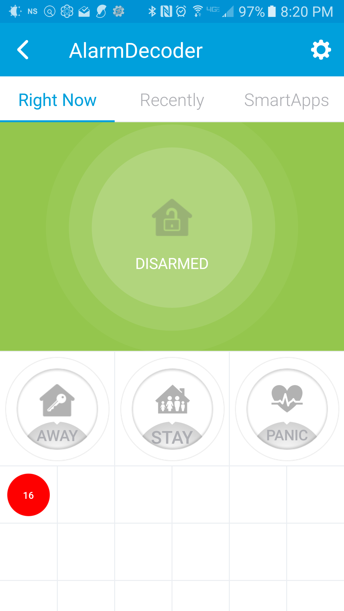

Here is my alarm view in ST. Wondering if you guys also get that red circle? I was hoping they would be green and red depending on status of zone. Mine does not change at all.

Mine shows the open zones in red.
did this change when creating the service manager app but everything still shows open instead of closed.
Just an update for you guys - we have released a new version of the AlarmDecoder WebApp as well as the SmartThings implementation. This fixes the red circle issue, fixes the delayed response issues, integrates with Smart Home Monitor, and fixes the open/close nomenclatures.
