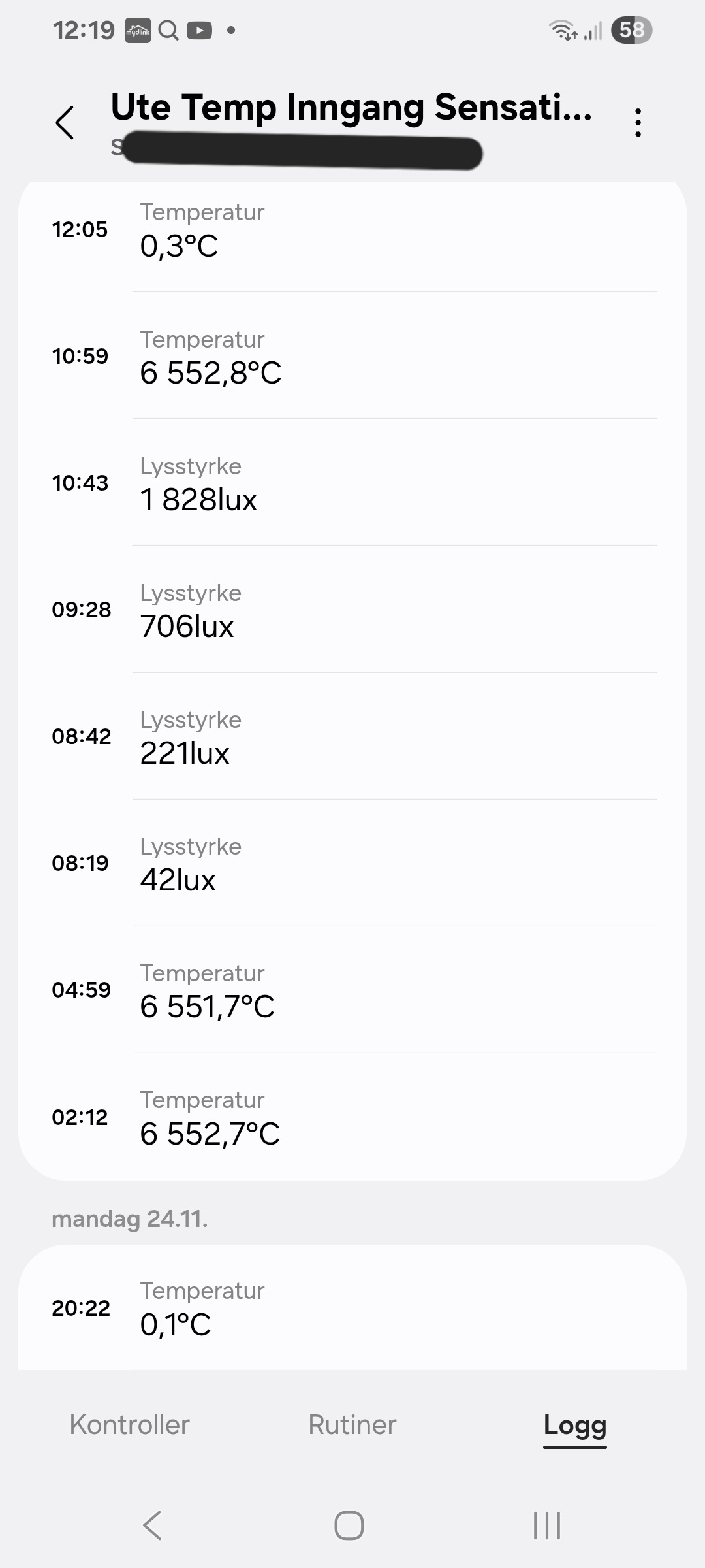

It seems that the most recent Z-Wave Sensor driver does not handle temperatures below 0°C very well?
It had for years until the september driver update
Device: Sensative Comfort.

Thank you for your answer! I guess a litte more context is needed.
This device is an outdoor mounted temperature - illuminance-sensor. The device reports at least once a day if the temperature does not change, but every hours if it changes by 1°C or as soon as it changes by 2 or more.
Thus , the screenshot of the device history covers a time period where the temperature falls from just above 0°C onto below freezing and then climbs back up above.
The negative temperatures reported by the device started showing up as 655x, y°C after an update of the driver, which may have taken place since last winter/spring. It may well be some conversion error or display error that leads to this behaviour ?
