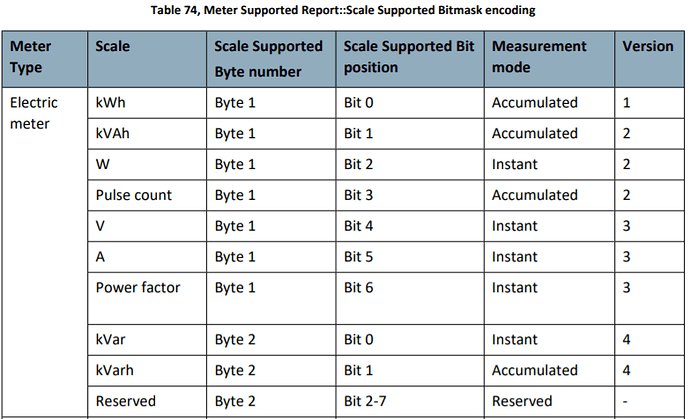

I specify the scale I want to get which links to a different energy reading, the decoding of the scales is shown in the table below from the Z-Wave command class spec below.
