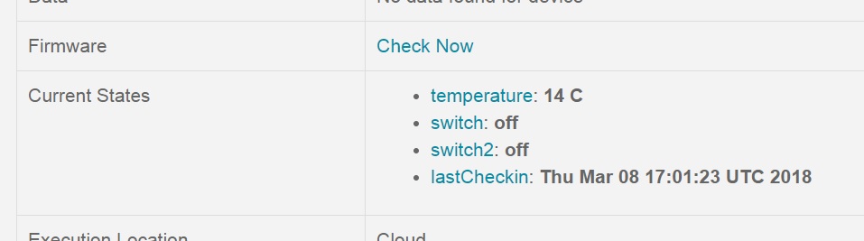

By ST App ::::
When I switch on or off for both switchs, I can see That changes in “Current States” of Aqara Device for both switchs. But one light (one switch) only work.

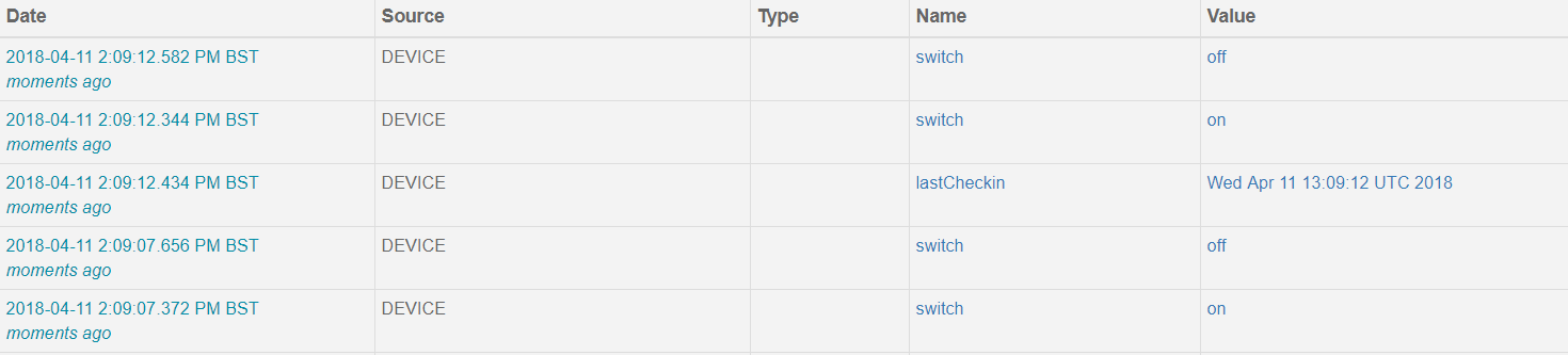

I have been using this light switch for a month or so and all seems to work fine for me - EXCEPT if I physically turn the lights on at the switch - ie turn on left hand switch then right hand or vice versa, the net result is that both lights are ON but in the app it reports them as off.
What I am seeing is that if I PHYSICALLY turn the ‘main’ light ON it shows correctly as ON in the app, if I then PHYSICALLY turn the second switch to ON then within the app it flicks quickly to ON then back to OFF and the other switch also goes to OFF.
Hence the app is not showing the true real state of the switch. This snapshot shows the device events - in this instance I PHYSICALLY turned both switches on, as you can see they flick to ON and then report OFF again immediately (although the light is still actually ON!)
Any ideas on this ?

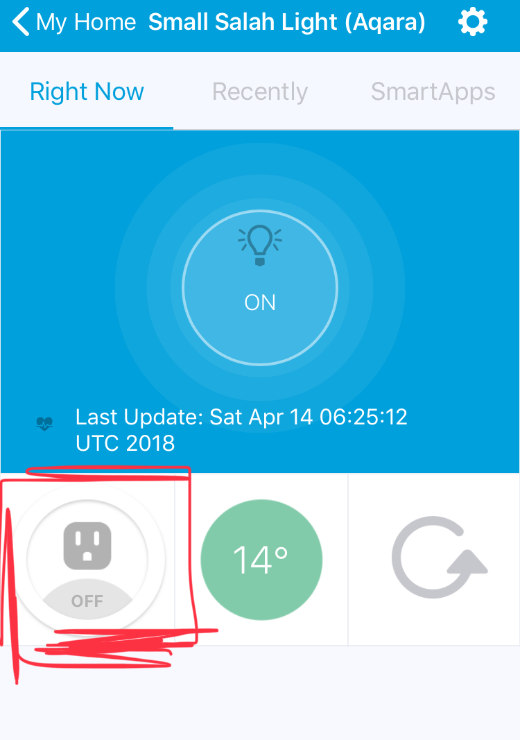

Up to day, I didn’t get solution for my problem. When I turn switch on one of them or both physically, that show me the main switch is ON in app. But, the secondary switch is still off. I think it should be ON if I turn on physically the second light!! Right???
After I installed the TWO virtual switch, one of them control the secondary switch correctlly. But it is still not control the second light. In app, Only the main switch is working for one light.

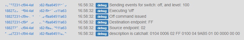

I wasn’t able to get the second button to be controlled by ST either, but I bought an Osram mini switch and it seemed to turn most of my stuff off all at once.
I’m not sure if this helps anyone, as I don’t know a lot about it, but the screenshot is from the live log when I press the Osram mini switch and both of those lights go off.
