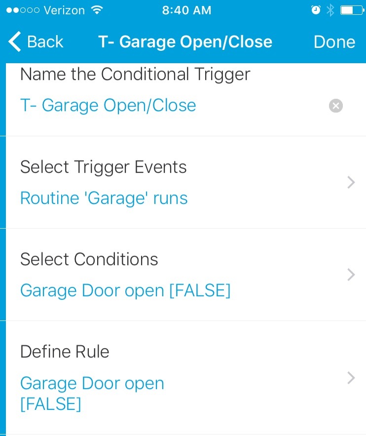

For anyone still using the discontinued app, I have a solution. A little wonky I suppose, but it works. I am also using Rule Machine, so it’s one unsupported app to work another unsupported app. Ah well, here goes.

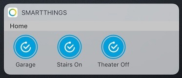

I have two rules, one that polls the MyQ sensor (that’s right, I am only using the MYQ equipment…no additional sensors) and one that open and closes the door. The latter is setup on a routine so that everyone in my household can operate it from a widget on their mobile devices, but you can certainly set it up however works best for you.
First the widget:
Now the polling rule (trigger really). This polls every five minutes or when a private boolean changes, which happens when the open/close rule runs:
Finally the open/close rule. This sets the private boolean and toggles the door between open and closed. I like to toggle so that the family has only one button to push like they would on a visor-mounted controller.
The delay is set for the boolean change. I am still playing with the timing of that. Sadly it can only be set by minutes, not seconds.
I hope this is helpful. I’m no pro and this took me a long time to work out. There is probably a better way to do this, but for now this is working for me.
