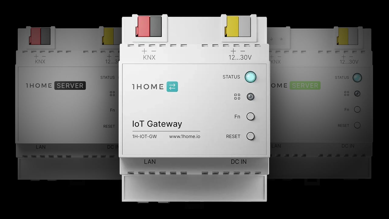

Have you considered smart building management with a Deepsmart KNX Gateway which is compatible with SmartThings?

What is KNX?

Hmmm, I looked at the site and at £1000 to be able to control more than 64 devices it doesn’t seem like a good option. When there are already such a multitude of existing products in the market, I don’t think I want to open up pandora’s box on having to code my own. Thanks for the suggestion though.
