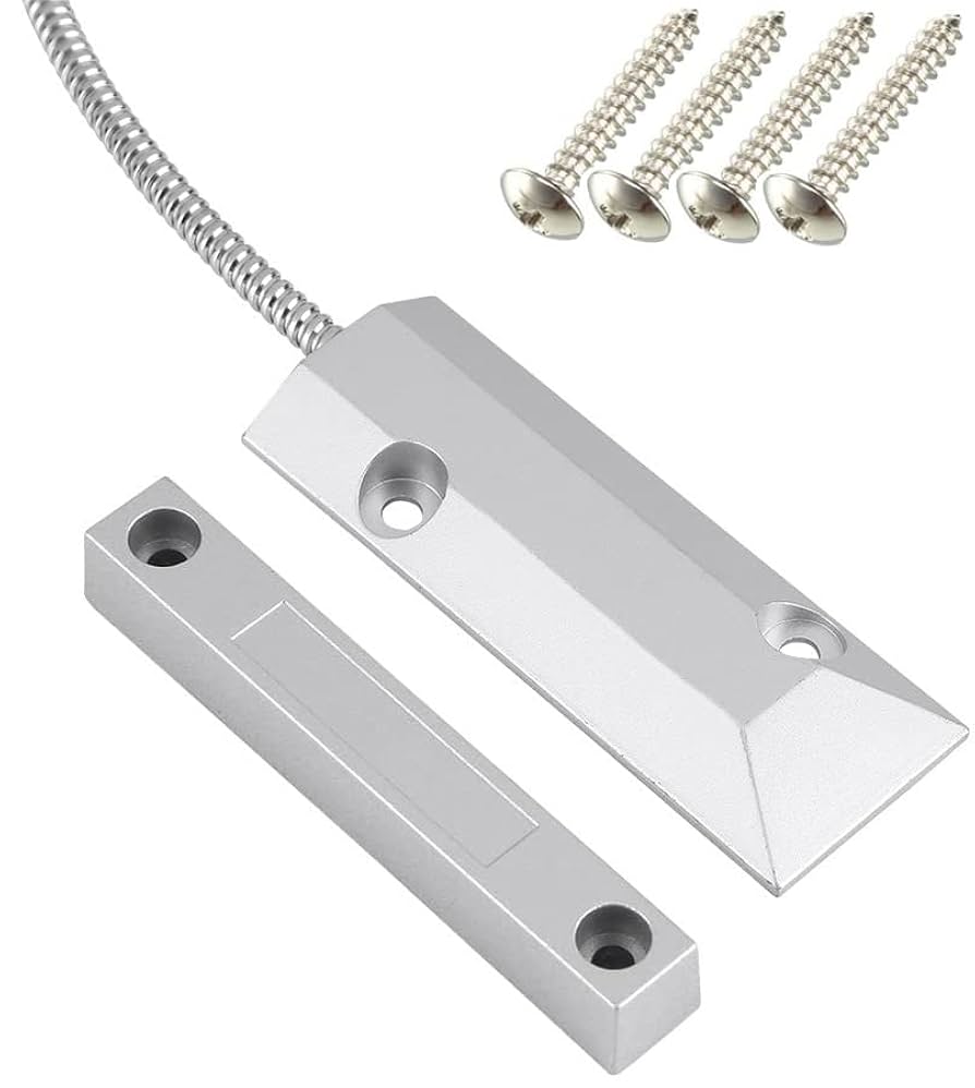

I want to apply a Wired Magnetic Switch on my outdoor gate like this one:
From my understanding this is just the switch part, and I’ll need a “controller” that checks the state of the switch and reports back to Smartthings.

I have one of those on my gate. You need a door/window contact sensor with dry contacts. My gate is very close to the house so I used the Ecolink Z-Wave Plus Door Window sensor to connect to ST and put it in a water tight case. You could also extend the wiring and place the contact sensor inside as well.
