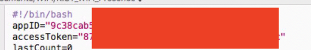

I made the “appID” the Client ID and the “accessToken” my Client Secret from the SmartApp oAuth.

As the error states, you are using an invalid token. You don’t use the token that is listed in the app’s settings but the tokens for the instance you are running (since you can run more than one instance of the app). Open the IDE logging and then open the SmartApp on your phone. When you tap “Done” you will see the correct credentials listed in the IDE.

I got the TOKEN and REST API from the IDE Live Logging.
I pasted the Token into the AccessToken on the script. Is my appID the ClientID from the OAuth settings? Or do I change it to the REST API?
Also, should I remove the “-” in the AppID and accessToken?

You use the REST API from the IDE logging.
No - you use them exactly as they are logged in the IDE.

I made the changes, but I still get an error. It appears a string of characters are appending to the end of my token. Could that be the issue??
You need to remove the trailing $
in both curl
lines
It works!!! Thanks so much!!!

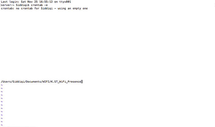

Also, how do I automate this with crontab -e? I pasted the path like this, but I am not sure how to save it so I can close Terminal?

Looks like you’re using vi
as your default editor – I don’t really use vi
so you would have to read up on that or change the default editor to something else (such as nano

I will look into that…for now I just have this running on Terminal every 100 seconds. Seems to work.
