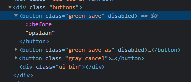

Hello everyone, I experienced the same problems. However, I came across a work-around.
I saw an error in the developer console from bootstrap, so I presume the styling doesn’t update correctly.
If you inspect the save button element and then manually remove the disabled tag from the button, you are able to save your program.
REMOVE DISABLED TAG
It sounds like it shouldn’t work but is does. It apparently works in their back-end, but front-end styling is scuffed.
