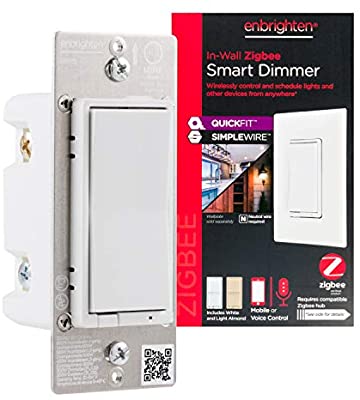

Size of the switches is a real issue. I’ve got a lot of 2- and 3-gang boxes. Doing 3 smart devices where they’re all on one circuit and so can have power and neutral daisy-chained is doable. If there are multiple circuits or other additional cables, it’s pretty tight.
For that case, I’ve started using the new generation GE/Jasco devices, both Z-wave and Zigbee. They advertise as 20% smaller and are definitely a help. Another advantage of these for multi-gang boxes is they don’t have heatsink ears that need to be snapped off.
GE Enbrighten Z-Wave Plus Smart Light Dimmer with QuickFit and SimpleWire, 3-Way Ready, Works with Alexa, Google Assistant, ZWave Hub Required, Repeater/Range Extender, White & Light Almond, 46203 - - Amazon.com
Enbrighten Zigbee Smart Light Dimmer with QuickFit and SimpleWire, Pairs Directly with Echo 4th Gen/Echo Show 10 (All)/Echo Studio/Echo Plus (All)/Eero Pro 6, White & Light Almond, 43080 - - Amazon.com
