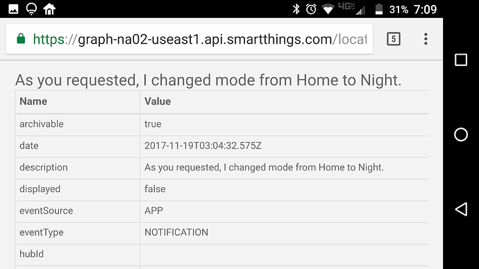

Just go to Locations and select Notifications. The From and To Mode is stored there. That’s as close as you are going to get.
You can also see your Routines that ran under Events with a type of LOCATION API / routine executed.
Additionally, you don’t even need to open each Notification to see the mode. Either from a desktop or rotate your phone in landscape mode and you can actually see the Text column in IDE for all the Modes to the far right (like below):
