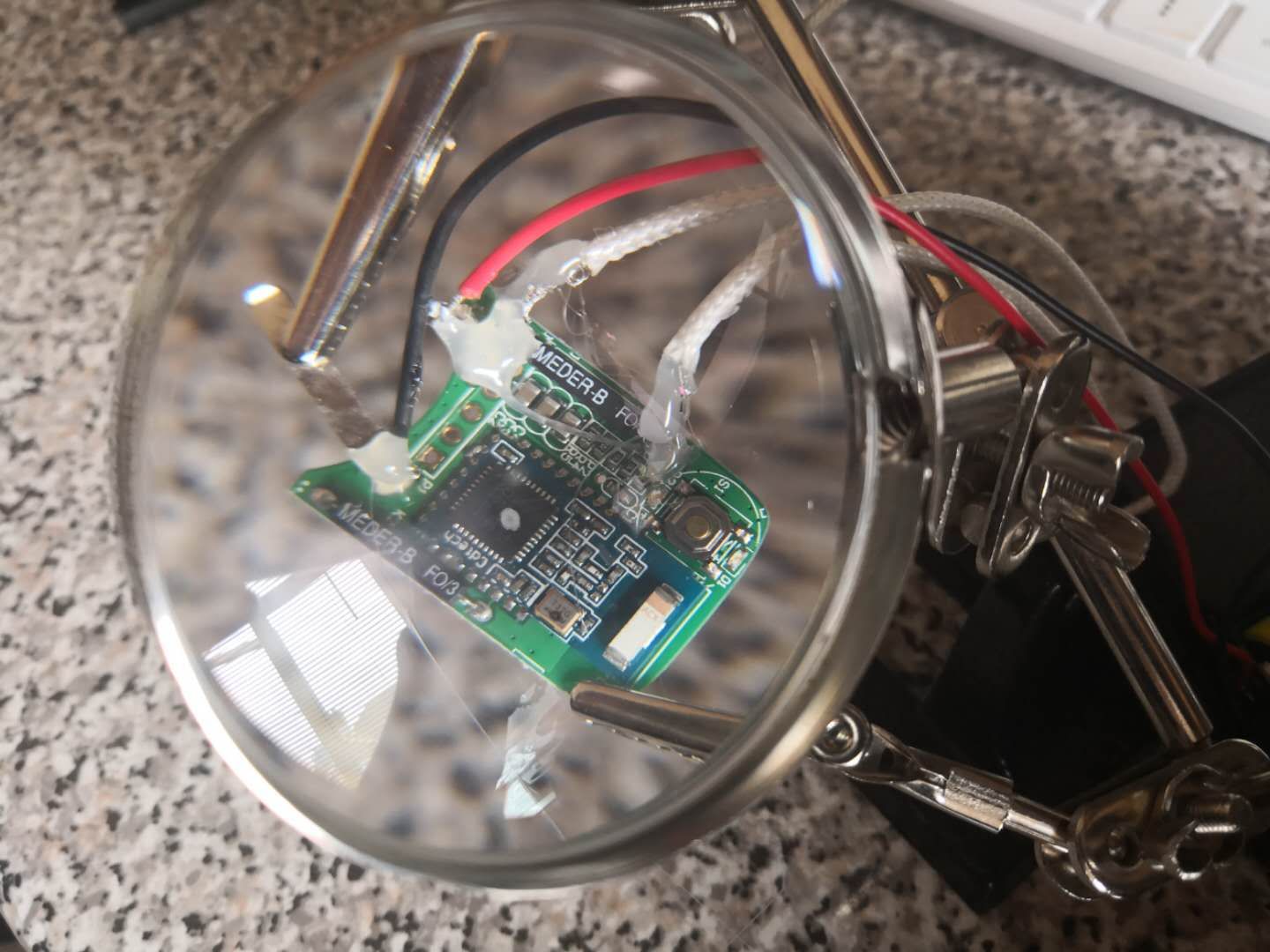

I took an orvibo contact sensor and a AA battery box…
Opened the access hatch to the reservoir and drilled a hole in the flap to attach a stainless steel water float sensor
!mmexport1569015980435|375x500
Took the sensor apart and soldered some connections to the first sensor. Covered these soldered connections with a glue gun for extra protection. Placed the sensor into the battery box after reconfiguration of the battery box to accept two AA batteries.
Refitted the hatch together with sensor and battery box in a plastic bag for extra waterproofing. Hidden under the slate.
Rewrote the orvibo handler to look like a water sensor.
Sensor has been working fine for two months and had to refill twice in the hotter weather. With warning messages handled by a webCoRE piston…
