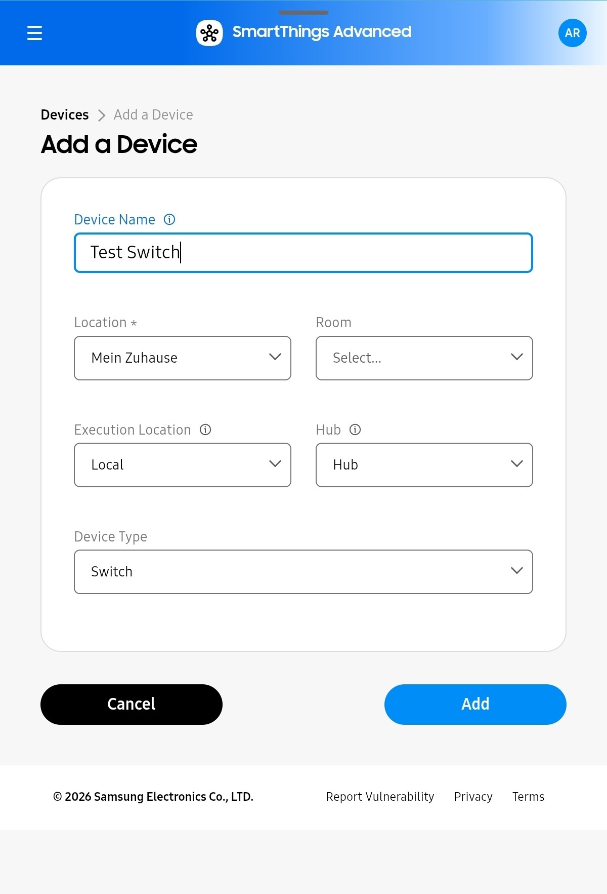

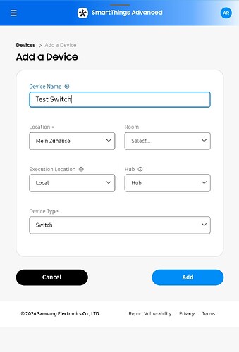

You know that you can create virtual devices natively in the AWA?
I guess I’ll need the instructions on how to set this new VS up. Thank you!
