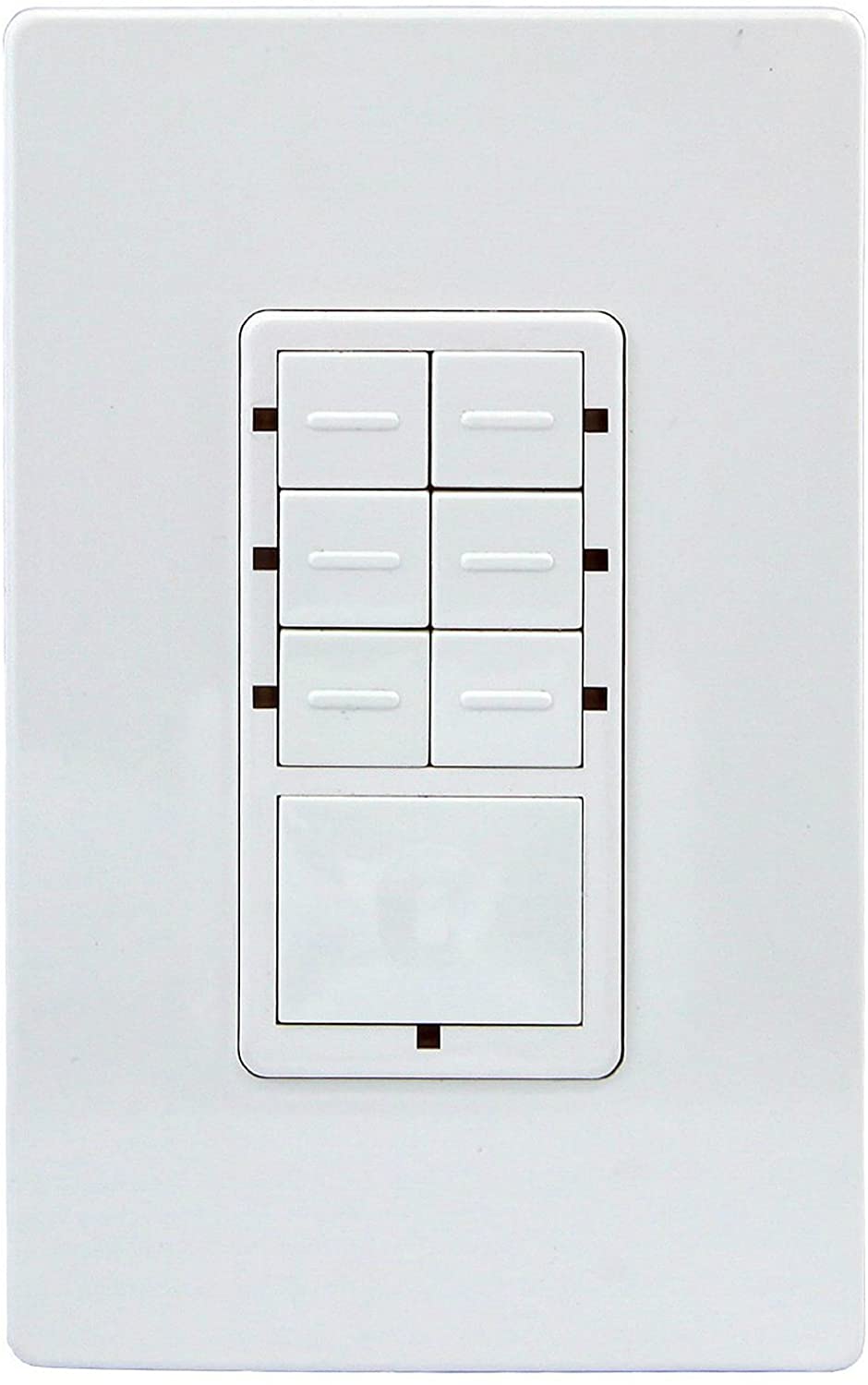

Use Cooper RFWC5 as a multi button switch?
Just bumping this hoping someone has had success with the RFWC5.

So if I have two Hue bulbs, connected via the Hue Bridge and want the “scenes” to do the following:
Scene 1: Both bulbs soft white, 1% dimmed
Scene 2: Both bulbs soft white, 50% dimmed
Scene 3: Both bulbs soft white, 100% dimmed
Scene 4: Both bulbs cool white, 100% dimmed
Scene 5: Both bulbs color, controlled by ST (color changing every 30s)
On/Off button turns the two bulbs on/off.
Could I do that? The bulbs are connected to ST via Hue’s bridge.
As far as I’ve been able to get things to work, the quick answer is no.
While the are some SmartApps for SmartThings that are supposed to work with assorted “things with buttons” but I didn’t have any luck getting them to work.
I had a Cooper Aspire controller. I set up the scenes in the Aspire controller and then transferred the scenes to button I wanted on the 5-button switch. I couldn’t have gotten it to work without the Cooper controller.
I don’t have any Hue bulbs, so I don’t know if I could program them in the Cooper controller to do what you want. IF the Cooper controller could be programmed that way, then you could transfer them to the switch. You’d need to find someone with a Cooper controller and Hue bulbs to try that out.
Absolutely not possible if you’re planning to use the native scene controller capabilities of the Cooper device, because those are zwave commands and they will only work with other Z wave devices that are within one hop of the Cooper device.
Hue bulbs are zigbee, the Hue bridge is using LAN, neither can accept a zwave command of any type.
If someone has set up the Cooper device to act as what SmartThings calls a “button controller” which means that every press of a button on the Cooper device sends a message to the smartthings hub, then you can use it just like any other button controller such as a minimote or a SmartenIT 3 toggle or an enerwave SC7. So you press the button on the device, it sends a message to the hub, and you have a smartapp which then sends a message to whatever your end device is.

Thank you. While I am aware of the z-wave/zigbee incompatibility, I was (vaguely) asking whether ST can in fact sense pushed buttons on it, therefore acting as the middle man in this whole business. I can take it from there, but it appears it works with its own controller and does not allow low-level button control to ST. Was hoping I can use that in lieu of a ZWN-SC7 which I honestly dislike because of its appearance. Just looks ugly to me. The RFWC5 on the other hand…
It’s very expensive, but the Leviton VRCS4 Will work as a button controller with smartthings. You might like the aesthetics better. It’s definitely higher quality engineering than the Enerwave.
Yeah, don’t like that one either, too bulky and the buttons come out too much. I liked the Cooper, flat(ter) looks. I have two kitchen island overhead Hue bulbs that I am currently controlling with a 12724 GE dimmer that’s not really connected to the LEDs (they’re hard wired to line) but uses ST to sync the LED switch/level to the dimmer’s switch/level. But WAF is damaged because she wants to be able to go to soft white, sometimes dimmed soft white, sometimes full blown cool white (most perceived light), while I like them in color. When you come home, they turn a random color along with the philips hue lightstrip that’s spanning across the belly of the three overhanging cabinet sections. Pretty cool. But she still wants them dimmed soft white at any other time. Go figure…
Understood. Coopers are my favorite zwave switches, I like both the aesthetics and the engineering. It’s just this particular device doesn’t fit the ST architecture well.

My Vera Lite bit the dust a few months ago (battery leakage) and I switched to SmartThings because of its good reputation for integrations (IFTTT, Lexa etc.) I have 3 Cooper RFWC5 Scene Controllers installed around the house. I realize that ST doesn’t support Z-Wave scenes - but I would very much like to be able to get some value out of the devices passing button-pushes back to the ST hub. I’ve seen several other posts asking about this… has anyone gotten it to work? - Matt
I’m working on a solution for the RFWC5. I hope it will be ready use in a few weeks.
How is that solution coming? I am very interested to use this to trigger scenes in smarthings or stringify…
Couple impending factors delaying it. One I’m having issues with the getting the controller to config properly. Two, I’m not that skilled at programming. Three the weather is getting nicer up here in Wisconsin and outdoor projects are under way.
Right now I have the DH updating attributes that match the indicators on the RFWC5. Much of the issue revolves around the controller not doing much of anything until it is configured and associated properly to the hub. So I need to get that worked out.
Have you had a chance to look at the new Z wave Tweaker? It’s very cool. :sunglasses: You assign your zwave device to it temporarily, use the tweaker to set associations and parameters, then change it back to the every day DTH. Saves a lot of time.
I have it loaded up right now with the RFWC but I have not messed with it much. One thing I noticed is that it is reporting the configuration parameters differently than I have been seeing them. the configuration report my DH give shows size as FF but the tweaker shows 00 and the FF is part of the value. Both are wrong as the only 1,2, or 4 are valid for size but I’m interested to see if there is a clue to what’s going on. Its raining here today so I spend some time on it tonight.
