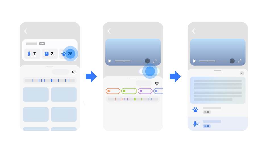

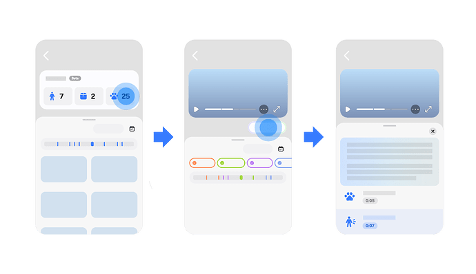

6. Video Service ‘AI Video Analysis’ (Beta)
AI identifies people, pets, and packages from camera footage, and provides automated titles and summaries so you can quickly find the footage you are looking for. In Pet Care, users can filter activity by category or create AI webtoons from pet footage.
  • How to use: Go to Life tab > SmartThings Video
  • Eligibility: SmartThings Home Camera 360 & Pet Care users (US/Korea). Limited to the first 1,000 participants.
    ※ The location admin must access the feature first, after which location members can also use it.
    ※ This is a beta service, and participation will close once capacity is reached.
