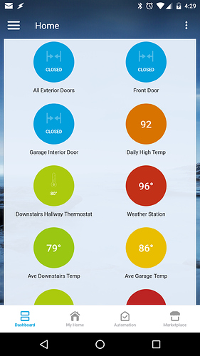

I have pulled this together using examples from the smartthings forum, webCoRE forum and other places. I wanted to get this posted and will be adding attribution at a later time, but a general thanks for all who share code/expertise and help us progress.
Utilizing webCoRE (pistons posted below), these DTH and child DTH (in github posted below) allow the grouping of similar sensors, like contact and temperature sensors, to show you an aggregated summary of the group through 1 simulated device like the “All Exterior Doors” and “Ave [group] Temp” things in my favorites below:
Grouped contact sensors:
Grouped temperature sensors:
There is an option below all of the child devices, to “REMOVE CHILDREN”. You can use this to remove all child devices, this can be useful instead of removing the device to force deleting all children. Saves time when adding/removing devices from groups and child devices persist for devices no longer in the group.
NOTE: when clicking on the “REMOVE CHILDREN” button, you will notice the status text (next to the refresh button) change to reflect the command has been issued. It can take a little while for the child devices to be removed from view. You might need to go to the main screen and back into the parent item for the children to be gone.
When first loading the parent (master) devices or after the “REMOVE CHILDREN” command has been used, you can re-populate the child devices by clicking the refresh button. This refresh button also manually forces an update to the group in daily use. The child devices will also be create automatically the next time the webCoRE piston runs.
As with the “REMOVE CHILDREN” function, it can take a little while for the children to appear when they get created as well, so give it a little time to refresh on its own, or go back to the main screen and navigate back to this item to try and force it.
