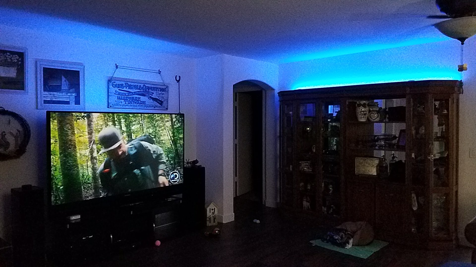

Thanks for the advice and the GREAT pics! Your project looks awesome! I do have a few questions - can the controller address/control more than 1 strip? I’d like to have lighting strips both under and on top of the cabinets (I have 4 cabinets that will need to be lit - above and below) and I’d like them to function as 2 groups - under cabinet group and above cabinet group). To compound this complication, the cabinets are separated by two doorways - so I can’t really run wires between groups. I’m thinking this will mean I will need 4 controllers for the under cabinet group and 4 controllers for the above cabinet group - does that sound right? I will be putting all the electrical and controller hardware above the cabinets then using the extension kits to wire the under cabinet lights. Thoughts?
Thanks!

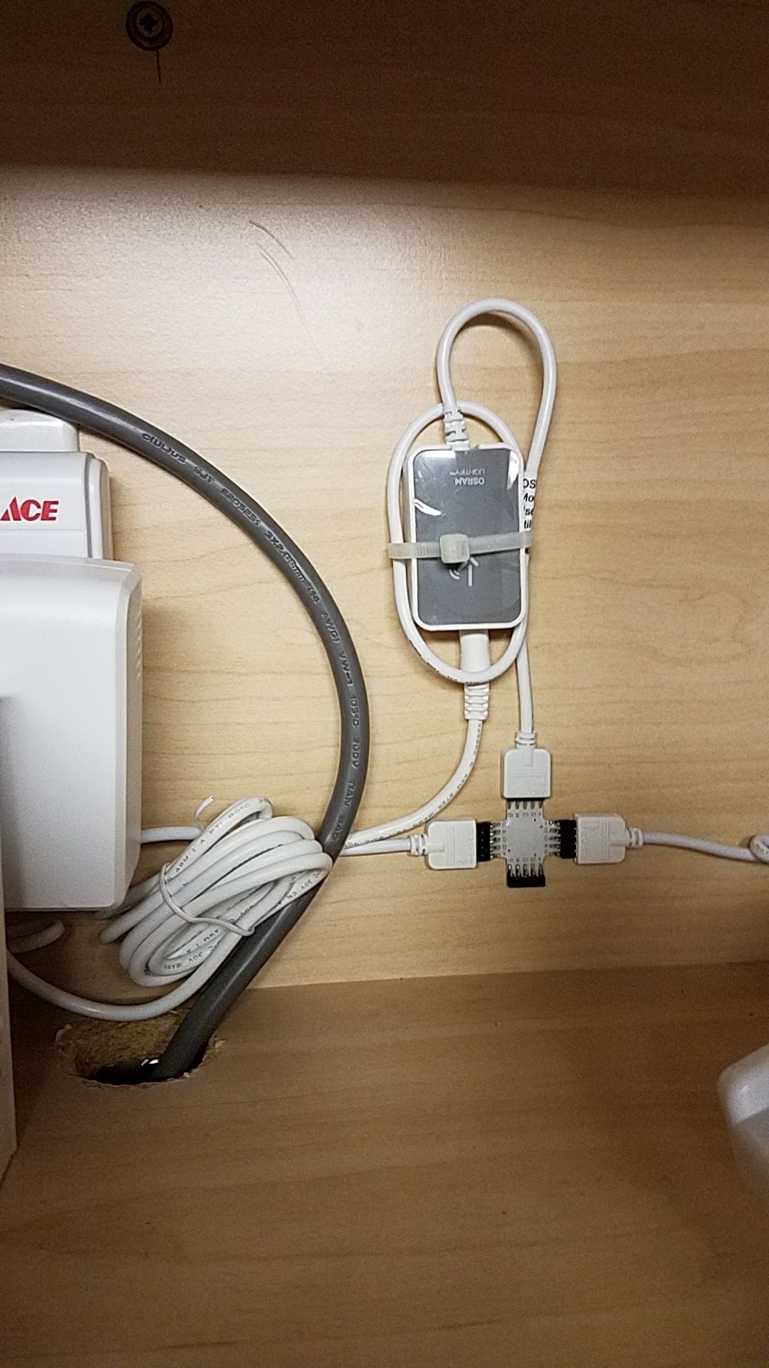

The controller can control one strip of lights, so if you want upper and lower lights you will need two starter kits as each would need its own power and controller. If you wanted to control both upper and lower with one controller you could but would most likely need the extension kit for the extra cables.

Each of the starter kits have the controller and power in them So if you have to buy four kits your covered. You do not need the gateway at all like OSRAM folks will tell you. I almost sent mine back then tried to pair and it worked. I found that the only thing really was the extra cables is what I needed and in fact I’m doing the 10’ shelf at the top of the kitchen cabinets this weekend so I’ll post a few pictures of that when done.
