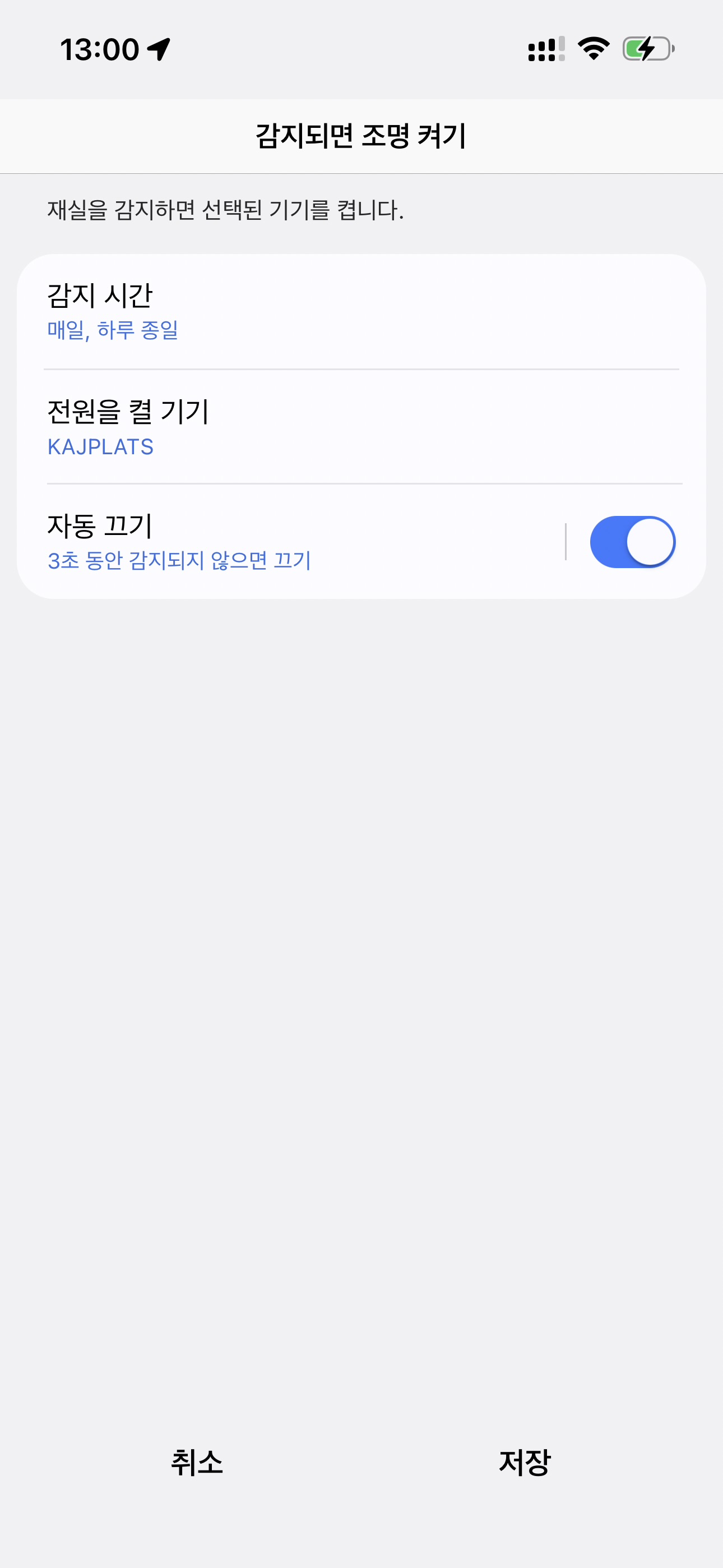

I have set up a routine in FP300 device page in the app to turn light on automatically when presence detected and to turn off after 3 seconds after not detected.
I can see turning on the light works perfectly, but the light never turns off when no presence. I use the latest Matter bulb light from IKEA KAJPLATS.
Does anyone know if this is a bug, or if I’m missing something?

I used FP300 device page → Routine menu at the bottom → the very first menu (turn on when detected)
Currently, it is set to detect all day throughout the week and to be auto turned off after 3 seconds. I can confirm it turns on without issue but not turning off 3 seconds after absence

I’ve just looked to see what the Rule implementing the Routine does and there is a collosal bug in it. Specifically they are checking for presence being inactive instead of not present.
I also note that the Routine keeps getting marked as inactive on the device Routines tab even though it isn’t.
