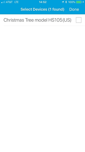

I have an HS105 plug that previously worked using an older beta version of the DTH and SmartApp. I’ve deleted those old versions and installed the latest versions of both - (Cloud) TP-Link Plug-Switch and TP-Link Cloud Connect. I can see the plug in the Kasa app and renamed it from (“Christmas Tree” to “Fan”) - I can control it and it has remote control enabled. If I log out of Kasa and back in, the plug is still named “Fan” and I can still control it.
When I install the new SmartApp, I enter my credentials and hit “Initial Install” it apparently logs me in, since it sees the plug, but it shows it with the old name (“Christmas Tree”) and installing the device shows a comms error.
Any idea what might be going on? Seems like the old device data is being cached somewhere.

Assuming you uninstalled everything TP-Link (devices, device handlers, smart app) and started from scrarch,…
The fact that the device is still named “christmas tree” indicates something with the Kasa App and cloud. Do not know what - but that identifier is coming from the Kasa cloud.

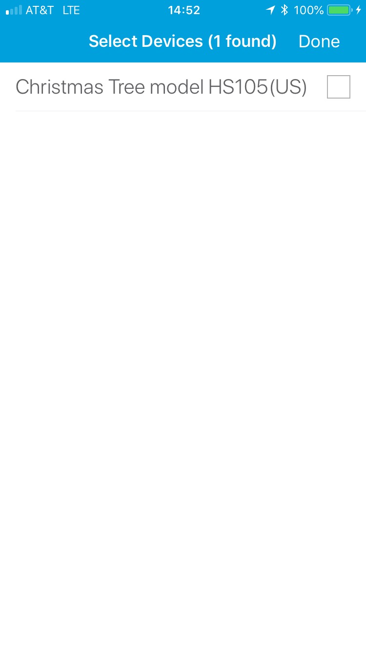

Only one account. I had logged out of the Kasa app and back in to verify that the right device was showing up. No errors on the phone when I add the SmartApp, enter my credentials and choose initial install. I’ve attached some screenshort showing what I see in the Kasa and SmartThings apps
If you have deleted the TP-Link devices, the TP-Link Device Handlers, and then removed and delete the TP-Link Smart App, then we should not be seeing Christmas Tree on re-install. If you did this (and I believe you did), then the name is coming from the TP-Link cloud (and therefore the question on two accounts).
This appears external to the SmartThings platform (in the cloud) where somehow your login is hooking to an incorrect server OR is hooking to the incorrect data. When you do the initial setup, my smart app pulls the server id from a global site. Then it goes to the server (identified by the global site) with the token and gets the device list. This device list is where the Smart App gets the device name (“Christmas Tree”).
Controlling the devices goes to the server with specific commands. So, if you are somehow hooking to an incorrect server, then it would give the symptoms (wrong device name and communications errors.
Two items, with me scratching my grey hair.
1… Log out of and back onto smartthings. DO NOT SELECT A location. Go to the My SmartAps section and see if an app appears there. If it does, it may be interfering in some way.)
2. ReVerify that the HS-105 is in remote mode (just in case).
So this is weird. I logged back into the Kasa app and under settings for the “Fan” device saw that there was a firmware update available (this had never displayed before). I did the update and went into SmartThings to reinstall the SmartApp. Wouldn’t you know it, the device name had updated to “Fan” and it works perfectly once I installed it.
I’m not sure how/why a firmware update would fix this, but it definitely jiggled something on the TP-Link side that fixed my problem. Thanks for your help on this and for your work on the app!
