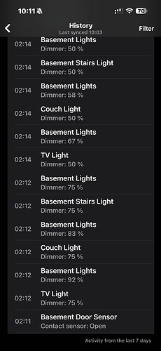

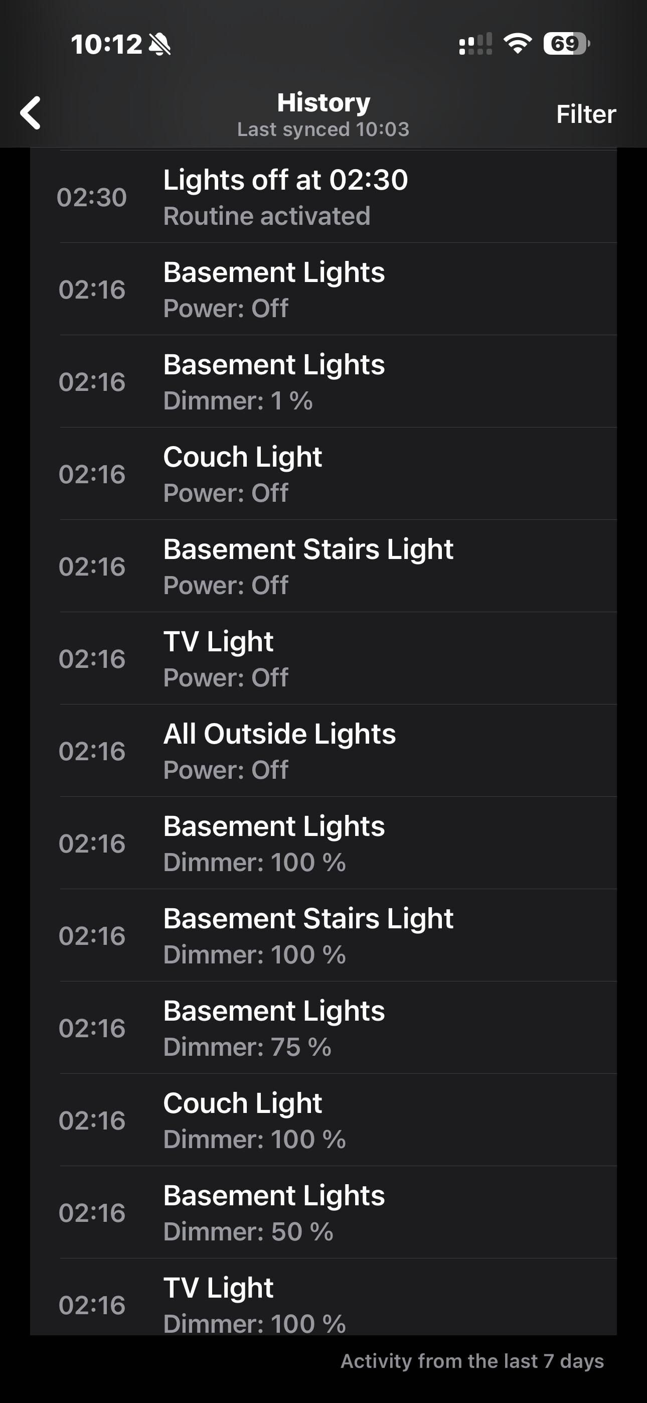

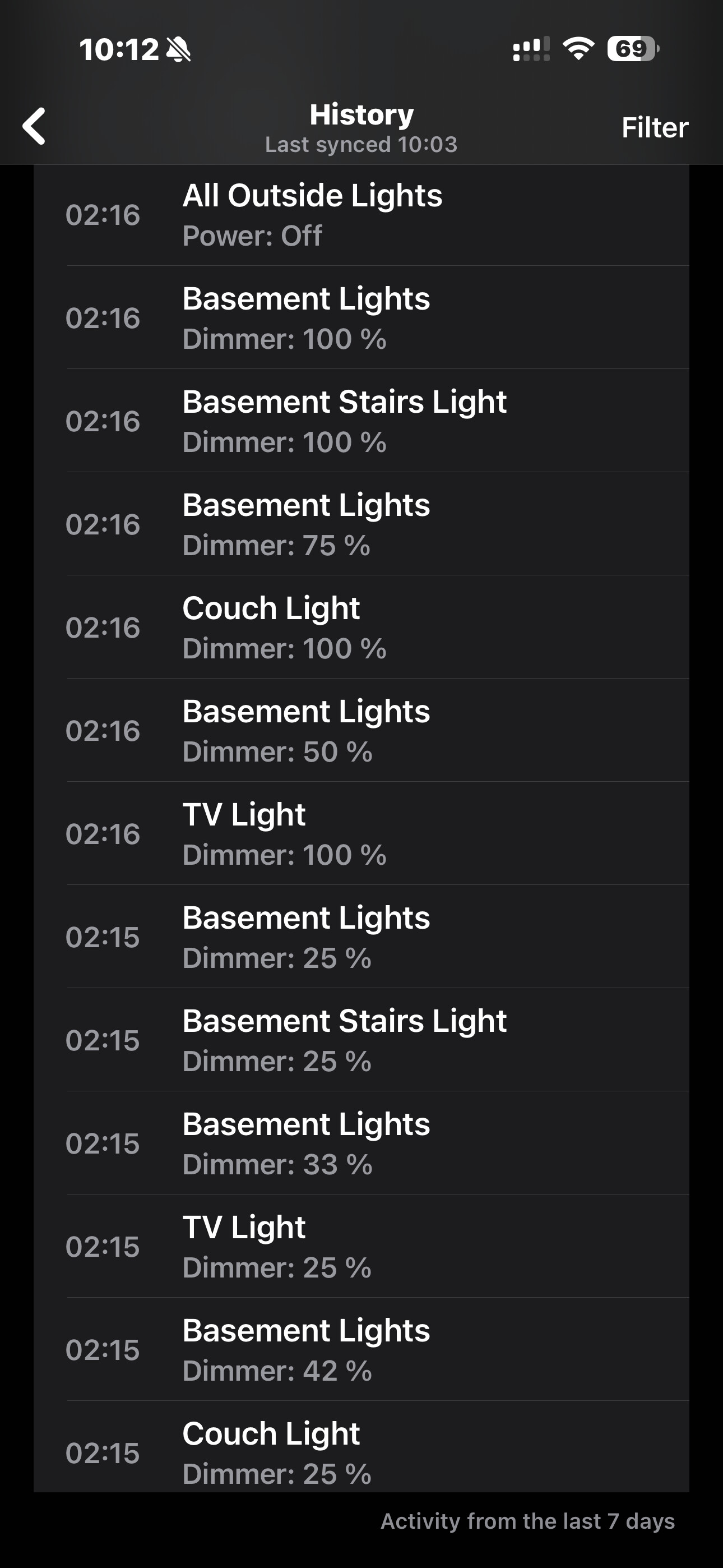

I have some lights that have a mind of their own doing things that I have no routine for and am hoping the community can help track down what’s going on.
The two biggest concerns are that I have basement lights going through some ritual during the wee hours and I also have an outdoor light that decides to shut off at random hours in the middle of the night rather than just after sunrise. Screenshots attached
basement lights is a group of all my lights in my basement
Standard basement door opens routine
Let me know what other information is needed to help troubleshoot. Many thanks in advance.
