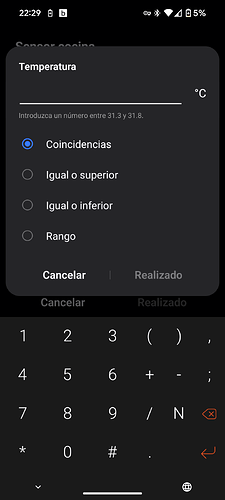

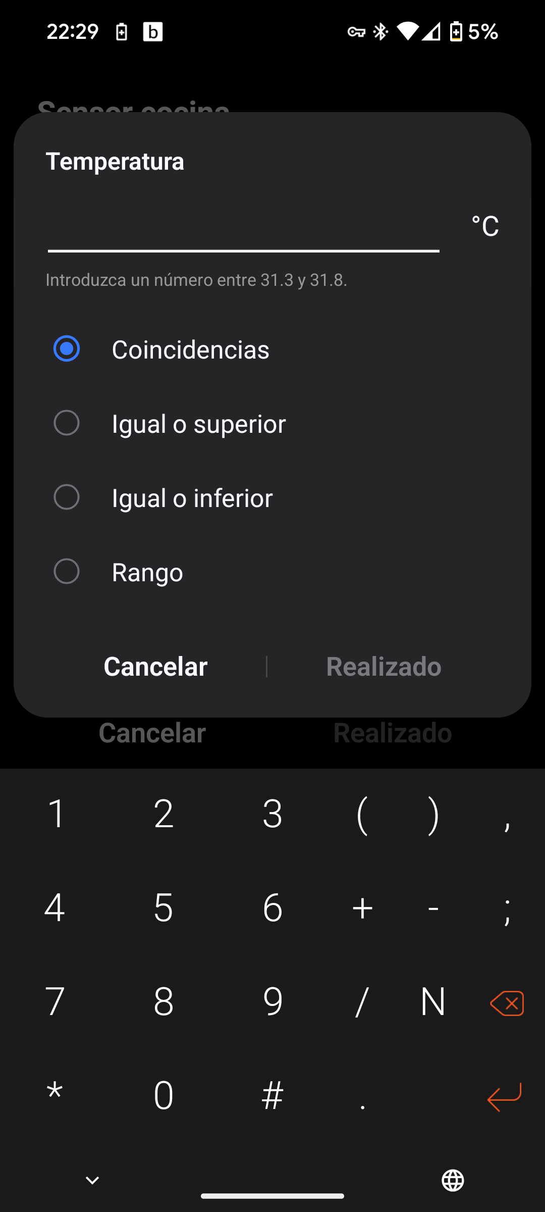

Hello @Mariano_Colmenarejo, I was just wondering if you managed to fix your devices? I’m experiencing the exact same problem you mentioned here with a couple of TS0201 sensors that have a range limit that doesn’t make sense (31.3-31.8), so I can’t use them for any automation. Maybe you figured it out. Thanks!
Tuya misunderstood what the attributes Min Measured Value and Max Measured Value are really for.
The standard says:
The Min/Max Measured Value information attribute set contains the minimum/maximum value that the remote sensor is capable to measure.
But they are storing the min/max temperature the device ever measured.
SmartThings drivers use these attributes to determine and set the range that can be used in routines, for example.
To expand the range, you can put your sensor in a freezer for half an hour and heat it up with a hair dryer afterwards…

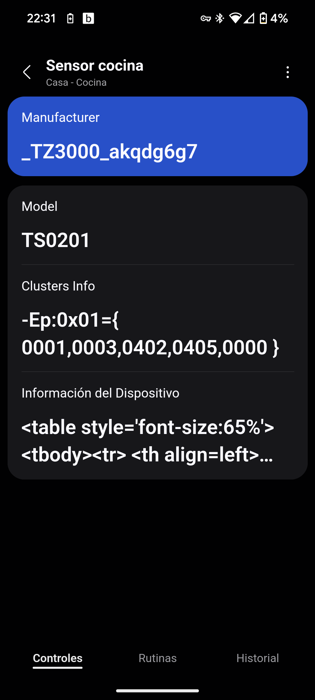

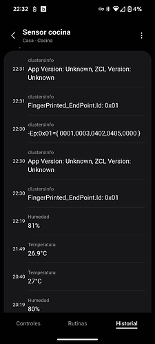

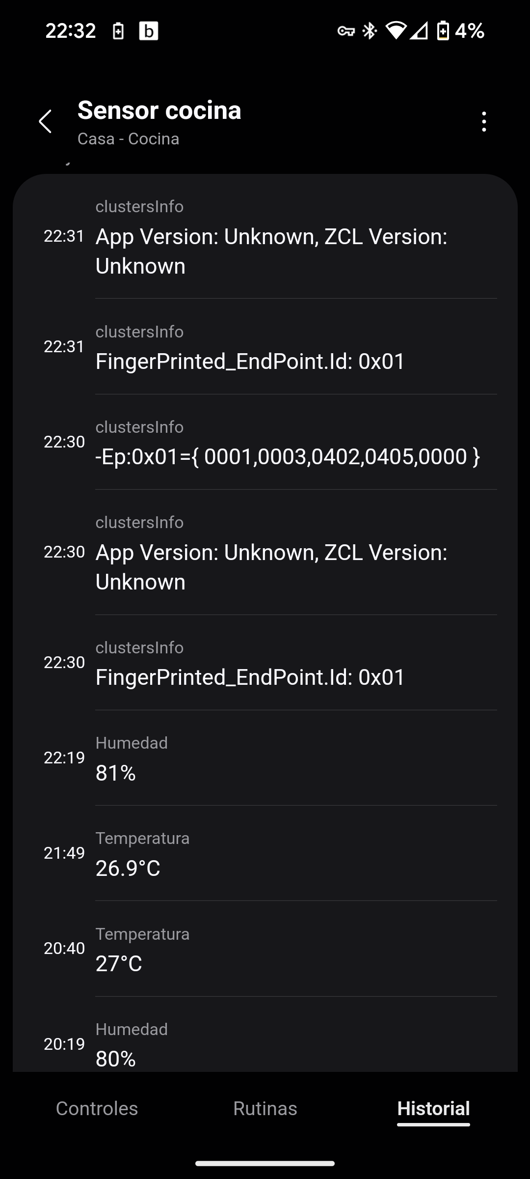

 Name         Zigbee Temp Sensor and Child Thermostat Mc
 Version      2024-12-27T11:13:11.243303163
- id: "_TZ3000_akqdg6g7/TS0201"
    deviceLabel: Tuya TS0201
    manufacturer: _TZ3000_akqdg6g7
    model: TS0201
    deviceProfileName: temp-humid-battery
 Name         Zigbee Temp Sensor with Thermostat Mc
 Version      2024-12-27T11:13:59.717256598
    model: TS0201
    deviceProfileName: temp-humid-therm-battery-05
Muchas gracias @Mariano_Colmenarejo!
This worked perfectly and I can now use the temperature range.
