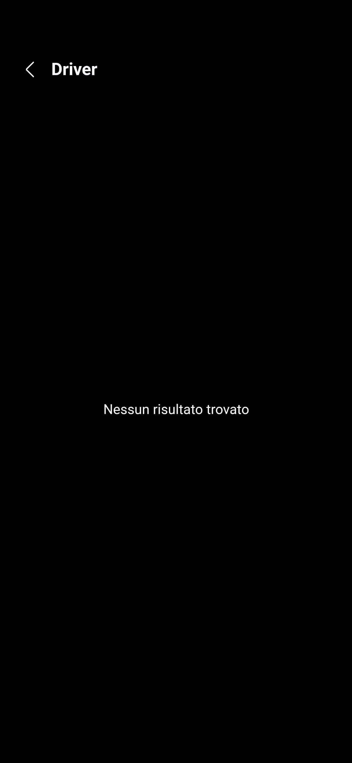

Click on the Seleziona altro driver button and see if you can change to the Matter Thermostat driver.
Thanks for the suggestion!
​I tried clicking “Select other driver,” but unfortunately, no other drivers were shown or available for this device. It seems stuck on the generic Matter Sensor driver.
​Appreciate the help anyway!

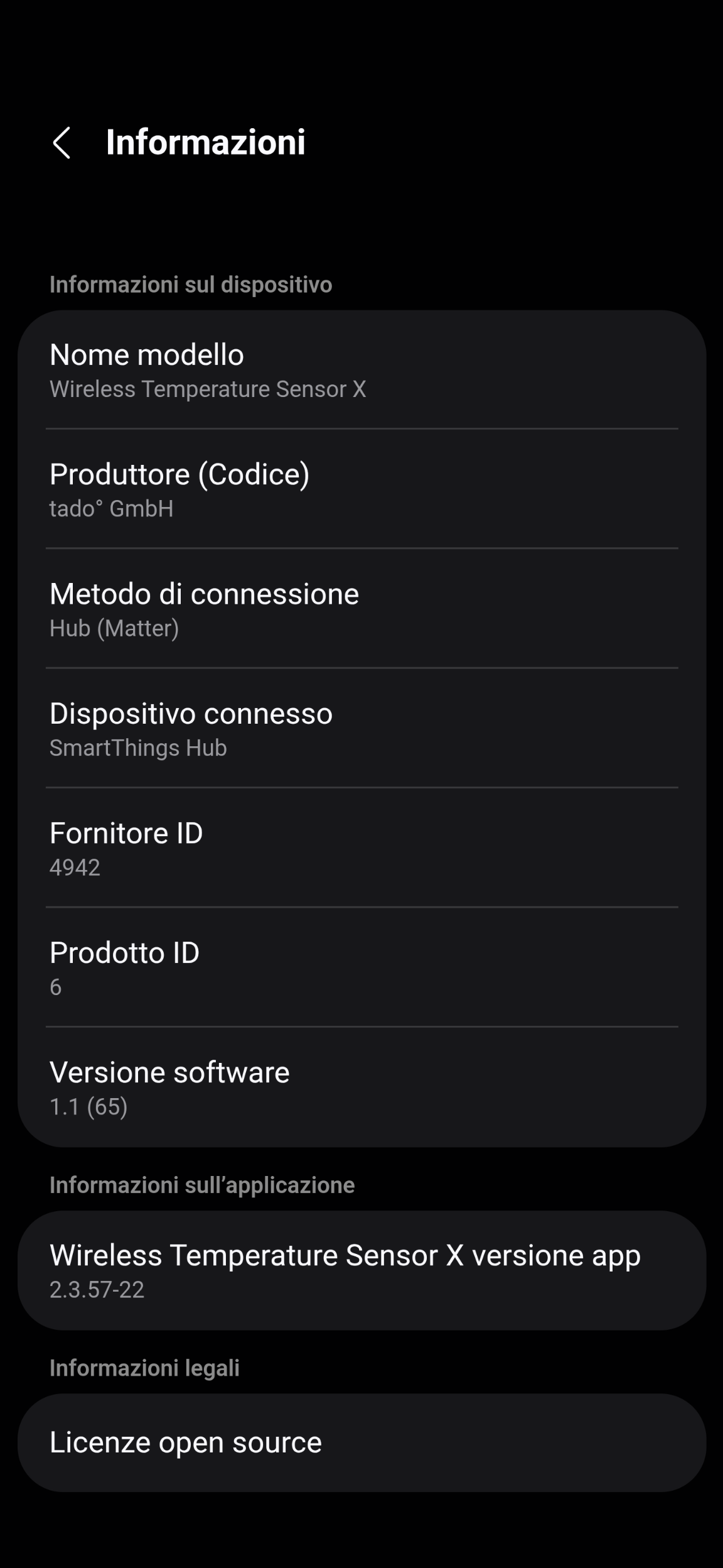

Post a screenshot from the information page.
Here
Thank you
