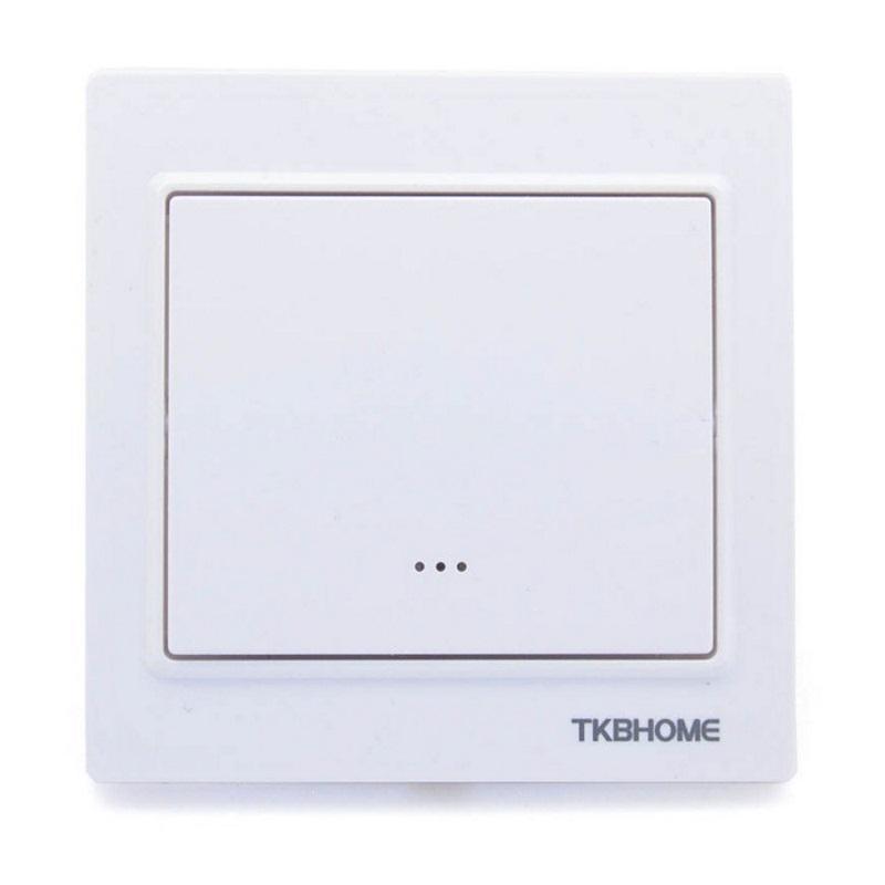

Also, if you have a neutral at the switch, the TKBHome line is an all in one available in either dimmer or simple on/off relay, double or single gang.
I have two gang of these, not dimmers though they do do them
£29.36 | NEO COOLCAM 3CH Z-wave Plus Wall Light Switch 3 Gang Home Automation Wall Light Switch Touch Control Remote Control EU 868.4MHZ
https://a.aliexpress.com/8TSGlOlTl
