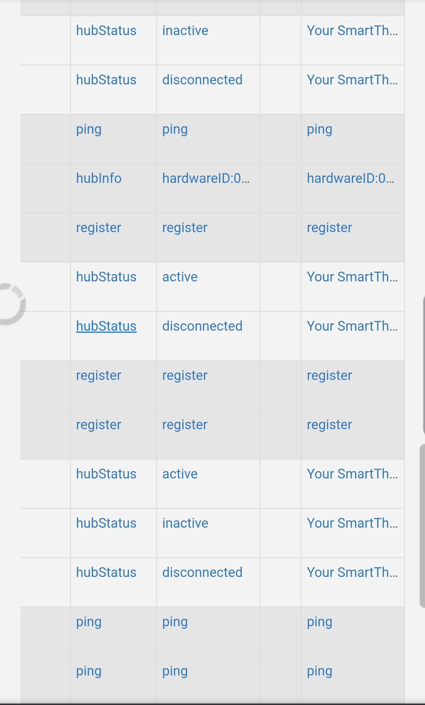

The hub events log shows a couple registration entries then disconnect and inactive. No other entries since then. That’s why I suspect Samsung has blocked the hub maybe due to too many registration attempts?
