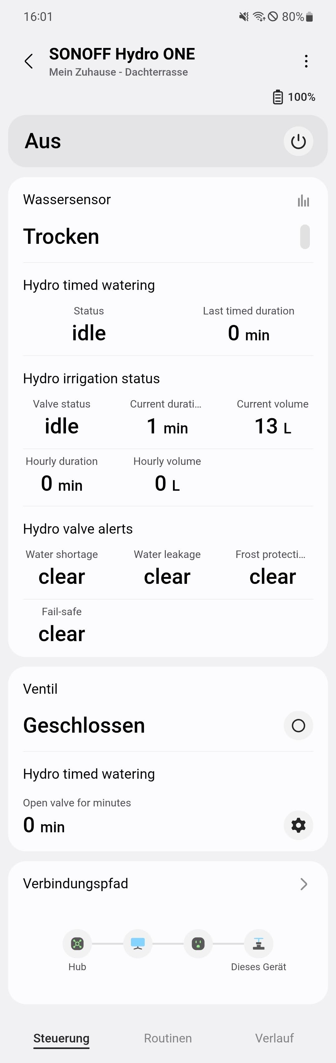

The driver includes a custom Hydro timed watering capability.
This allows the valve to be opened for a selected number of minutes using the device’s timed-open behaviour. The device then closes automatically after the requested time.
The UI exposes:
  • timed watering state;
  • last requested timed duration;
  • “Open valve for minutes” control.

The custom Hydro irrigation status capability exposes several useful runtime values:
  • valve work state;
  • current irrigation duration;
  • current irrigation volume;
  • hourly irrigation duration;
  • hourly irrigation volume.

Valve alerts
The custom Hydro valve alerts capability exposes abnormal valve states decoded from SONOFF’s private bitmask:
  • water shortage;
  • water leakage;
  • frost protection;
  • fail-safe.
Water leakage is also mapped to the standard SmartThings waterSensor capability where appropriate, so it can be used more naturally in routines.

Speaking of the eWeLink app - previously, when I was using the generic switch driver, I didn’t manage to connect to the device via Bluetooth while it’s also connected to the SmartThings hub (unplugging my ST hub to “force” the Sonoff into BLE mode did the trick). All of a sudden I can now use the eWeLink app using the proximity BLE mode and Zigbee control at the same time - I’m not sure if this is a side effect of a “proper” valve driver, nevertheless, this is now perfect.
Hint to other Hydro One users - initially I didn’t get volume readings regardless of using the eWeLink app or the driver - I think this might have to do with the Gardena micro drip system I have it connected to - maybe the water flow was just too low for the device to recognise. An internet search also pointed me to a possible issue with the “turning wheel part” inside the Sonoff coming off and blocking. So if you don’t get volume readings be sure to do a test with proper water throughput and if that’s not working either check if it maybe is a hardware issue.
@Andreas_Roedl your driver is a godsend, so please make sure you leave an info on how one can donate you a coffee!
