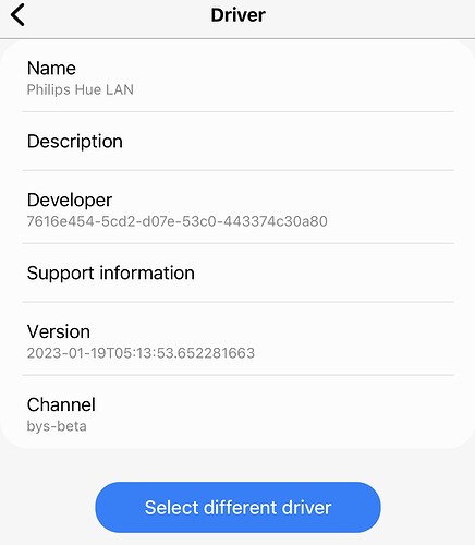

Hi @blueyetisoftware
It seems like i am on a older driver.
Am i right that i need to follow this steps indicated here to upgrade to the latest driver? Thanks
Yes. Follow this post:
