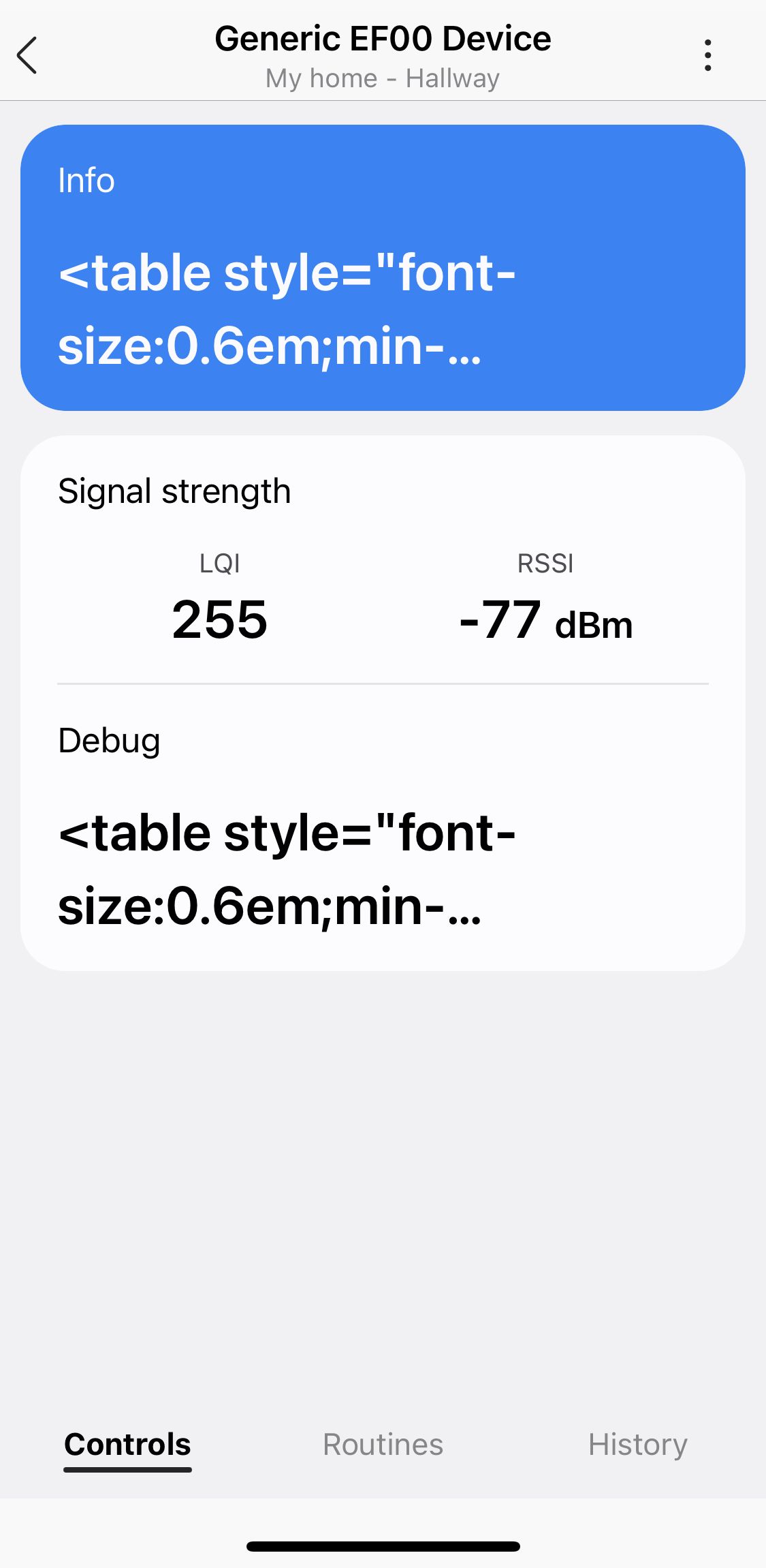

Hi, thank you for the driver. I have a Tuya Presence Sensor (WZ-M100-W) that doesn’t work 100% (Distance and Debug seem non-functional). I think this sensor supports Distance and two screenshots are attached, for first for the Generic Profile and the Second using the Presence Sensor profile. This is a link is to a thread where I first inquired about this and includes a pic of the sensor. If you can, please help, thank you. Cheers!
