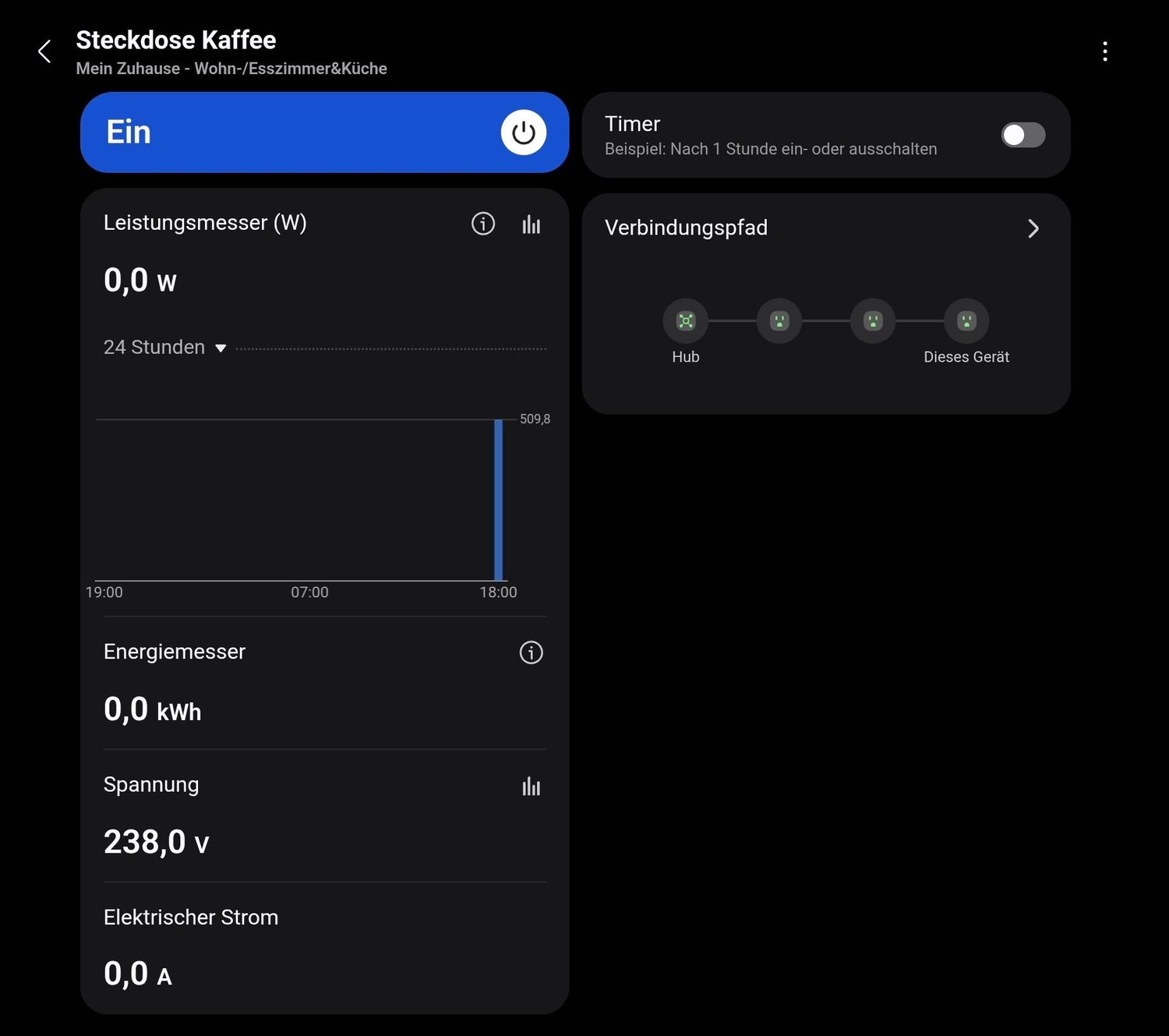

External testing so far indicates that the driver is on the right track.
Confirmed behavior at this stage:
  • the driver is selected automatically
  • the plug can be turned on and off
  • power reporting works
  • energy metering works
