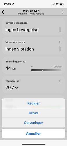

I have Fibaro motion sensors FGMS-001, that is zwave sensors with lot of setting parameters, to adjust the behaviour of the sensors.
One sensor was updated by Samsungs automatic migration to new edge drivers, and this contain all of the settings needed for adjustment.
Other sensor I excluded from network (exclude zwave device) myself and added again, and both sensors got the same edge driver Zwave sensor from the Samsung Smartthings repo.
The other sensor, did not have any settings meny, as the first sensor that was migrated by Samsung.
First 3 images show the sensor that I excluded and included myself.
Next 4 images show the first sensor that Samsung migrated, and this one has settings menu and all the setting parameters.
Notice that both devices has same driver!
Anybody has a clue what is going on?
Setting parameters are very important, as for example the light thresshold, can not be set to 10 lux, so it will only report light changes at default 200 lux changes if this parameter cannot be set.

Hi @Kina500
The two sensors are in the same driver but:
The product 0801 sensor is the most modern and is assigned to a profile that has almost all the configuration parameters of that device according to the manual.
The other model is the product 0800 and it is older, the configuration parameters are different and it is assigned to a standard profile β€œmotion-battery-temperature-illuminance-acceleration” which has no parameter setting preferences.
I guess that smartthings only migrates to Edge devices that Fibaro had certified for smartthings. The 0800 model should not be on the list, but Fibaro and smartthings should answer that
