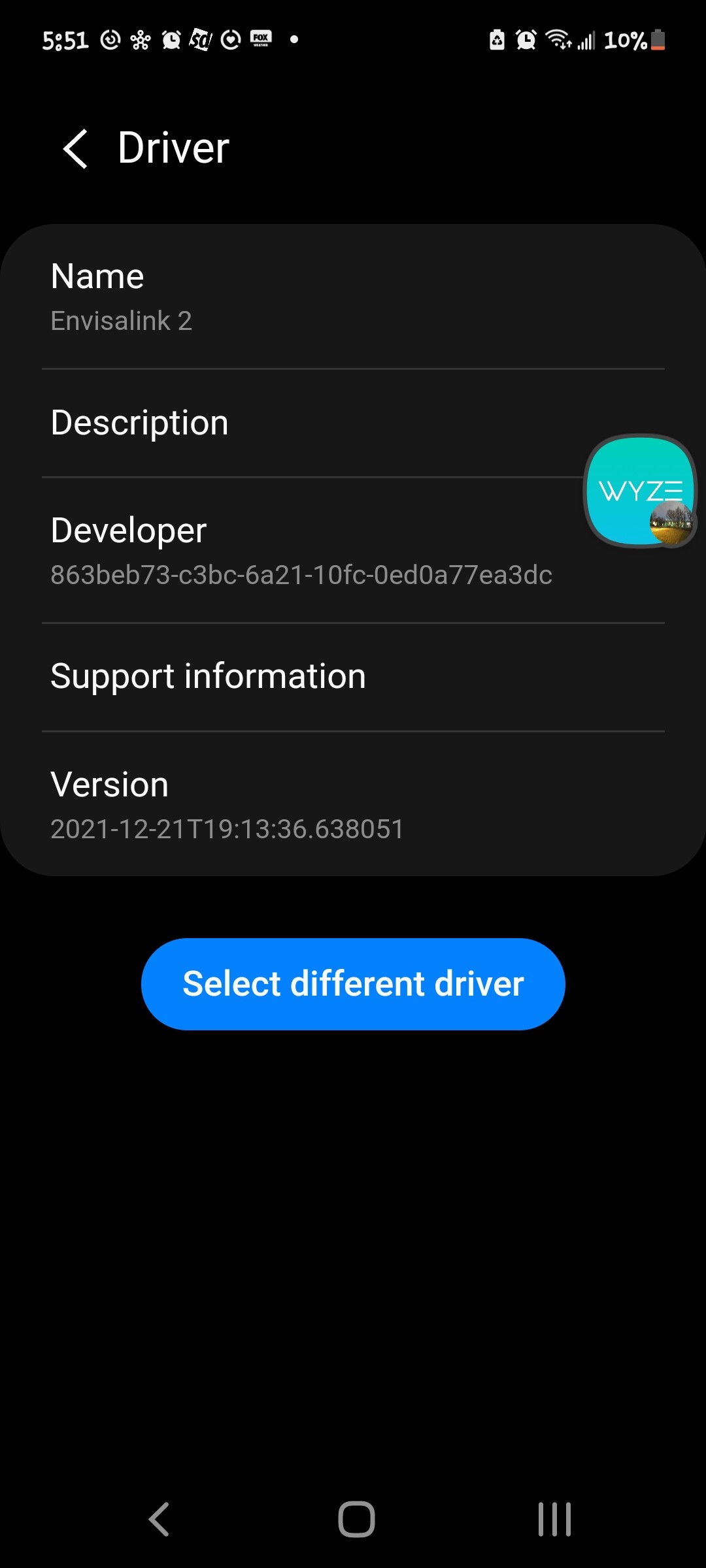

Hi Chester - No need to do anything if you were already on the 2.1 version. Normally Edge driver updates should happen silently and without problems. What will happen is that your driver will automatically get updated in the background and the driver will restart. Envisalink connection will get re-established and your devices should then continue work normally.
You can confirm the current driver version by going into your panel device details screen, tapping the three vertical dots in the upper right corner, and tapping ‘Driver’. You can then check the driver version.

Is this correct?
That is an older version, the current one is:
