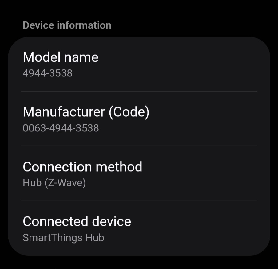

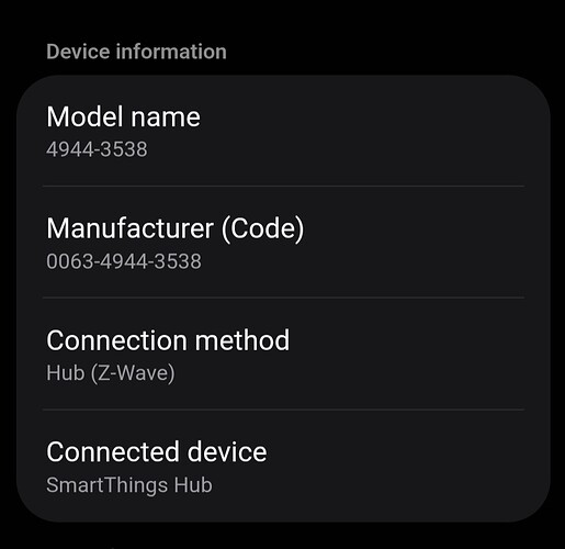

Hi, I just got the same dimmer switches. I tried to enroll to the edge driver for this but I dont see the driver. Has this been added to the driver already?
If it’s not showing as supported then I still need to add it. If you want, include a screen shot of the device info tab from the app.
It will be sometime next week before I can get to any changes.
Here is the screenshot of the device info. Thank you.
