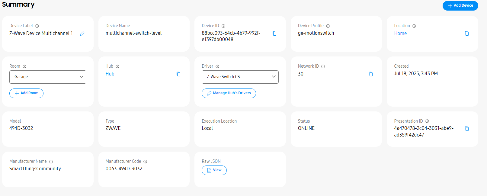

I have a question, if I added your driver after the motion switch (26931) was already paired to my hub. Do I need to remove the device and re-add it? I switched the driver over to yours but I still don’t see the motion function.
What is listed under the Information option under Manufacturer (Code) on the device? Thats the device signature, its possible your device is different.
Manufacturing Code: 0063-494D-3032
Thank you for your help!
  - id: "0063/494D/3032"
    deviceLabel: GE Motion Switch 26931
    manufacturerId: 0x0063
    productType: 0x494D
    productId: 0x3032
    deviceProfileName: ge-motionswitch
This device should be supported as motion. You’re using Z-Wave Switch CS, correct?
Geez, I restarted the app, it’s now showing the motion portion. Thank you for helping me!
