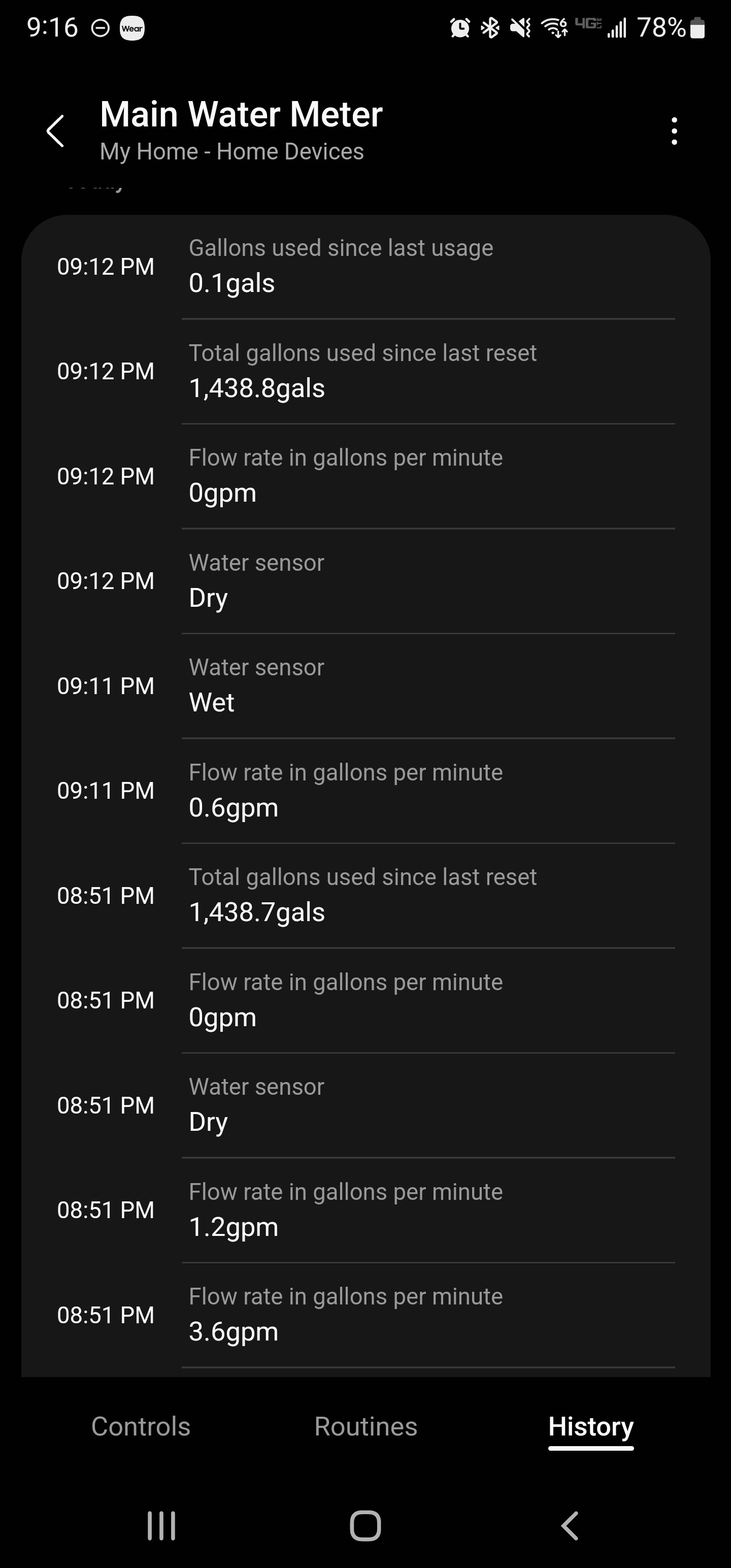

This is interesting. History is retaining my label translations and units, although the spaces between the value and unit is messed up. @ygerlovin @TAustin @Mariano_Colmenarejo @philh30 @veonua
Fyi @nayelyz
The issue where {{value}} wasn’t working in location history is resolved:
More interesting to me is that device history is populating with the alternatives I’ve specified in the presentation. I’ve been trying to replicate the way that fanSpeed works with the integer on the slider replaced by text, but haven’t managed to get it to show properly in detail view or device history. Maybe there’s hope.

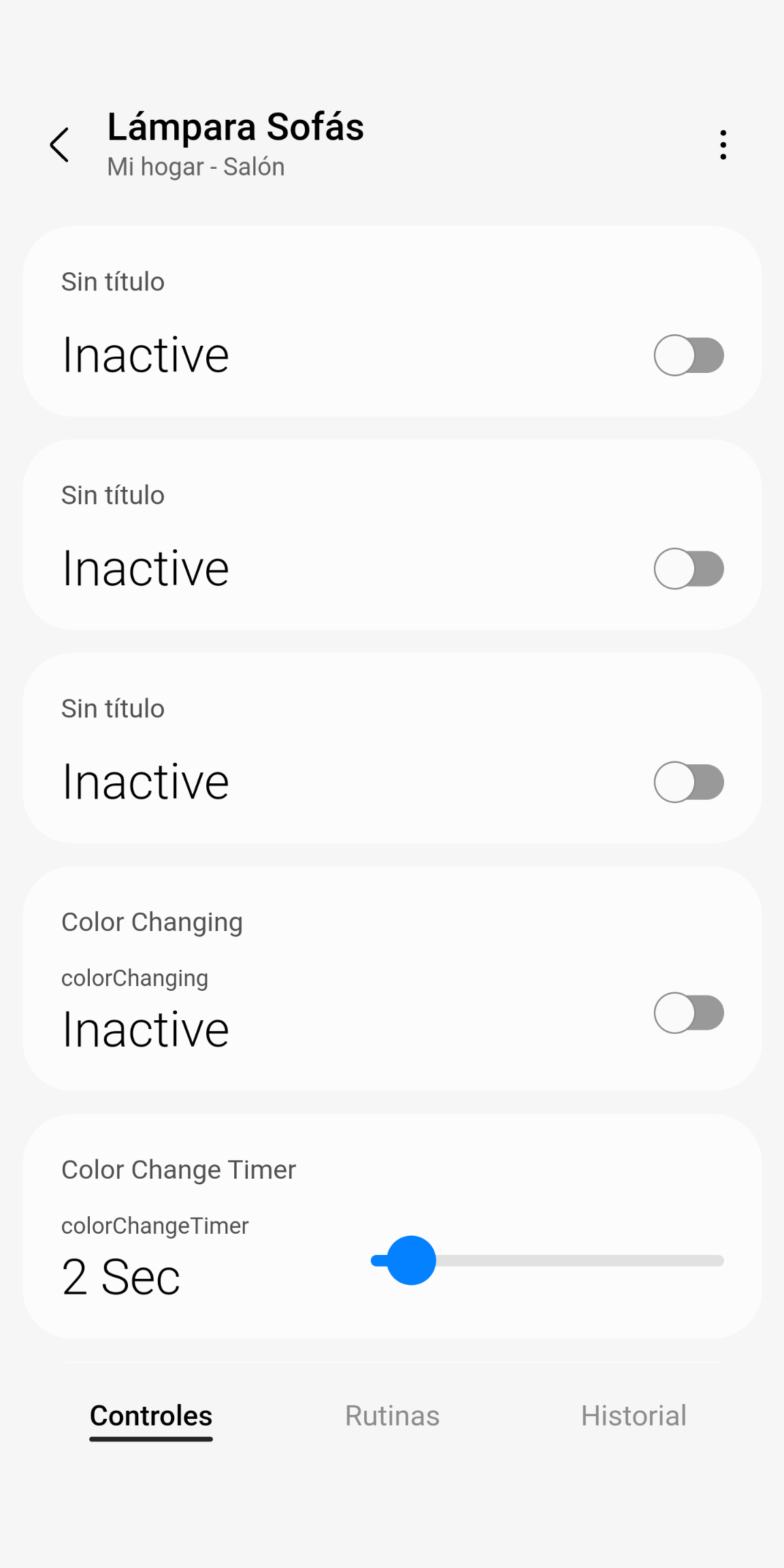

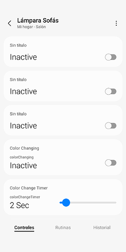

Whatever was done Friday night appears to have been reversed Sunday night. Anything that has translations is back to showing properly (though with duplicate labels). Any capability created somewhat recently without translations is back to showing the capability and attribute names instead of the labels defined in presentations. My older capabilities without translations are still showing as Unknown.
Hi @nayelyz
The untitled tags are the same as before the last incident.
in some the capability name and the name attribute are shown and in others it is shown without a title.
And the units in custom capabilities are not shown in the details view and are shown in the tile and in history
Hi @nayelyz , any custom capabilities recently created with translations is now back as @philh30 mentioned, but the units are still missing from the detailed view:
Same for me as others have reported. The ‘Untitled’ label which was on EVERYthing, has now reverted back to the prior state of showing the raw capability/attribute names.

Android update to 1.7.91.24 has removed the double labels on single-attribute custom capabilities - only the capability label shows, no attribute label. Both continue to show on multi-attribute capabilities.
Multi-attribute meaning more than one attribute, regardless of the presentation. Below are both custom capabilities. The bottom one has a supported modes attribute, and continues to show two labels even though there’s only one attribute displayed.
I did not modify any capability presentation and with this new Android version
In capabilities that appeared without a title in previous versión:
- they now appear correctly with the label defined in their presentation.
In which the name of the capability and the attribute were shown in previous versión:
- now it only shows the name of the capability, but not appears the Label.
What I don’t understand is why both before and now, capabilities that have the same presentation are still displayed in different ways in app
So it looks like with the new update I just received to my iOS app, that many - but not all - of the labels have been restored. I don’t really understand why some are back working, but others not.
