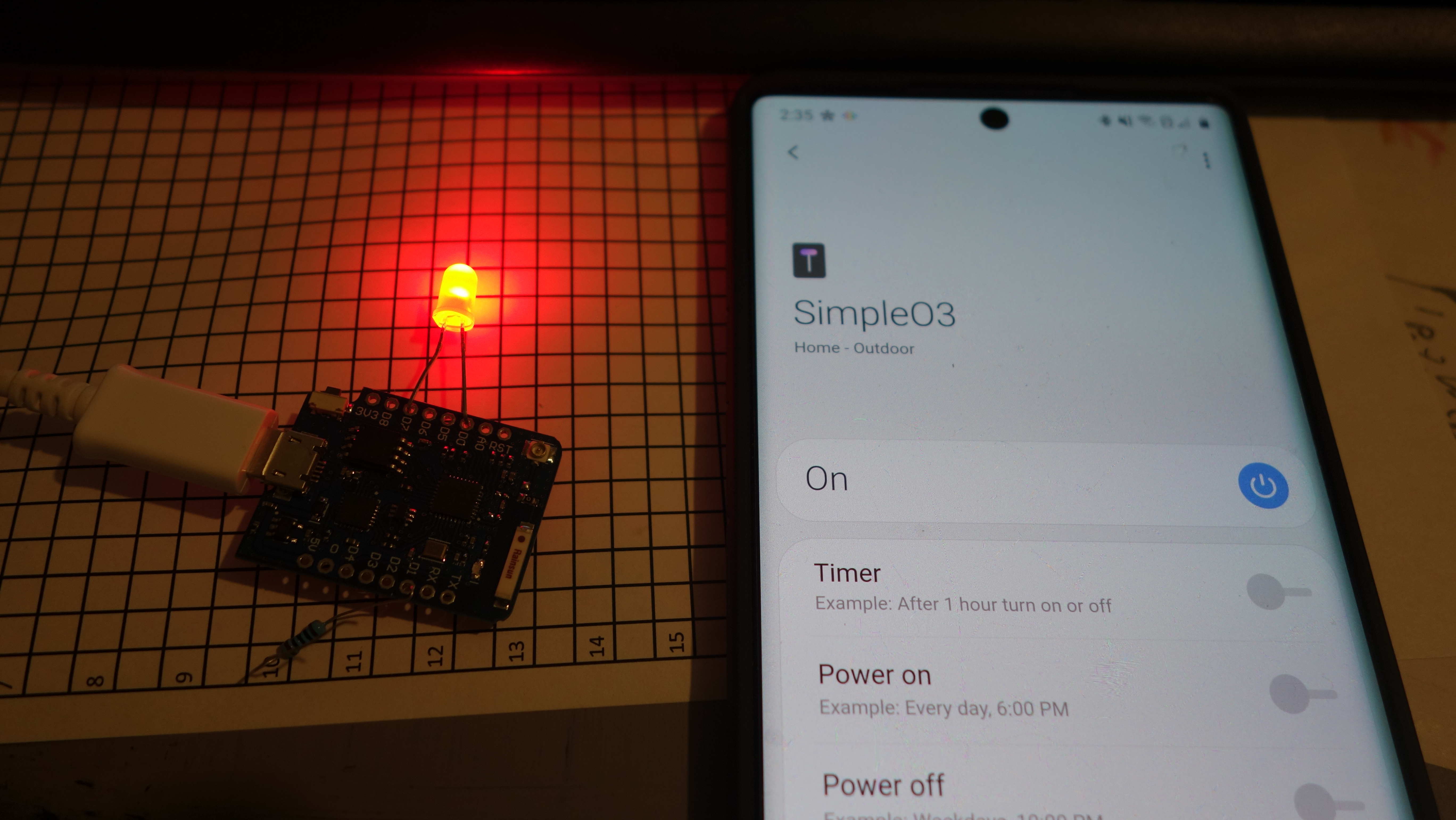

@bmc: what board you’re using for development?
Wemos D1 likein your pic - i just havent wired anything to it
