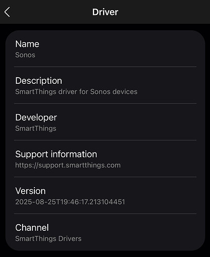

Seems like the new driver version has been released already. I haven’t have to remove and re-add the devices today, I will monitor over the week and see if keeps stable

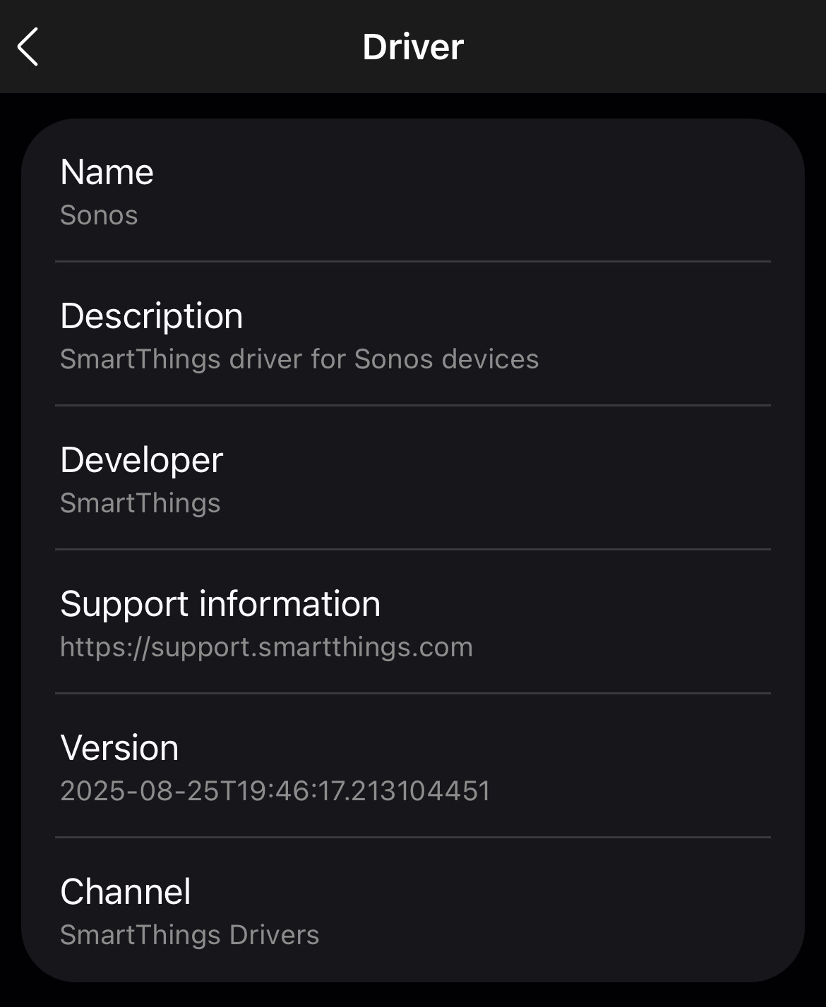

Hi,
This is the one I have, so seem like the latest one
Will let you know how behaves during the week
