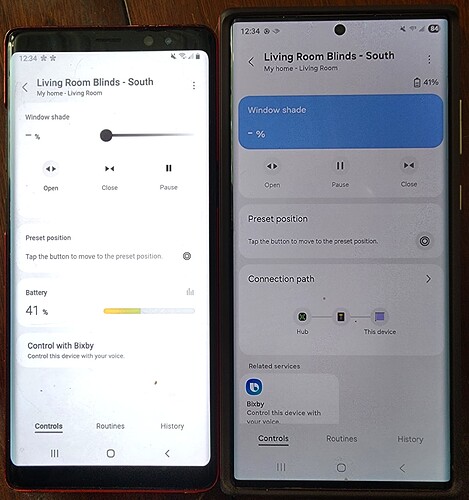

Here’s a picture of both the current version on the right and the older version on the left.
All of the buttons in the current version do not function (except preset), the other odd thing is that the battery percentage is working in both versions, so the device seems to be updating it’s status properly.
