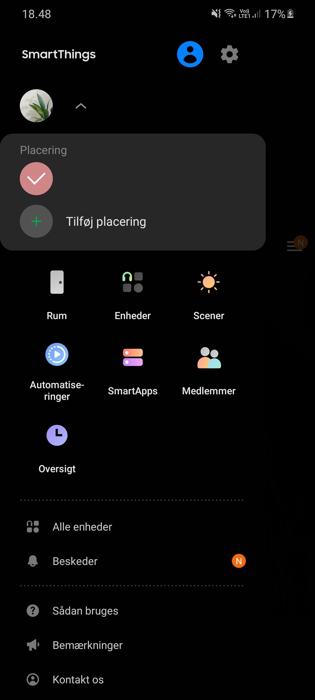

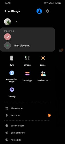

See if you can click on the menu and check how many locations show. Perhaps you have an empty one and you simply need to switch to the location with your hub and devices.
I can get in the menu and see this. Nothing happens when i press the different options.
If i try to make a new location i can give it a name, location and room, but when I try to add it i just get a message which say - failed.

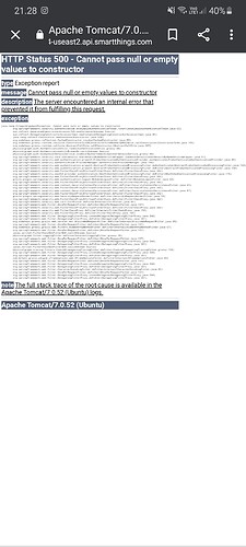

Are you able to sign in at https://account.smartthings.com ?
No, i did not delete my samsung account. I “left” smartthings. I am not sure what it is called in the english version, but I imagine it is the option called - leave smartthings.
Tried to sign in, but got this… now im very confused…

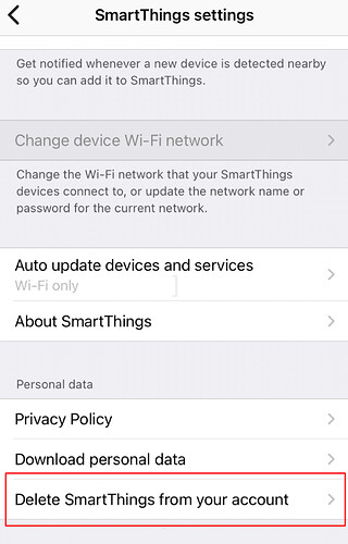

Did you tap “Delete SmartThings from your account” / “Slet SmartThings fra din konto” in the mobile app?
I pressed this:
And yes, i suppose it is the same as what you refer too.
But I did the exactly same on my girlfriends Phone, and I have no trouble on that
Ok thank you for confirming. That is an account deletion and would explain why you are unable to access the app or IDE. I believe the “issue” will resolve 7 days after the time you performed that action. Alternatively you can create a new Samsung account though that is not a good option if you are using other Samsung services tied to the original email address.
