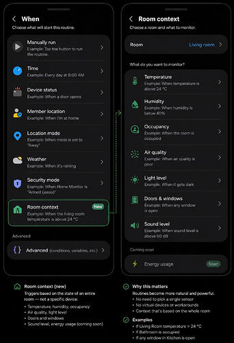

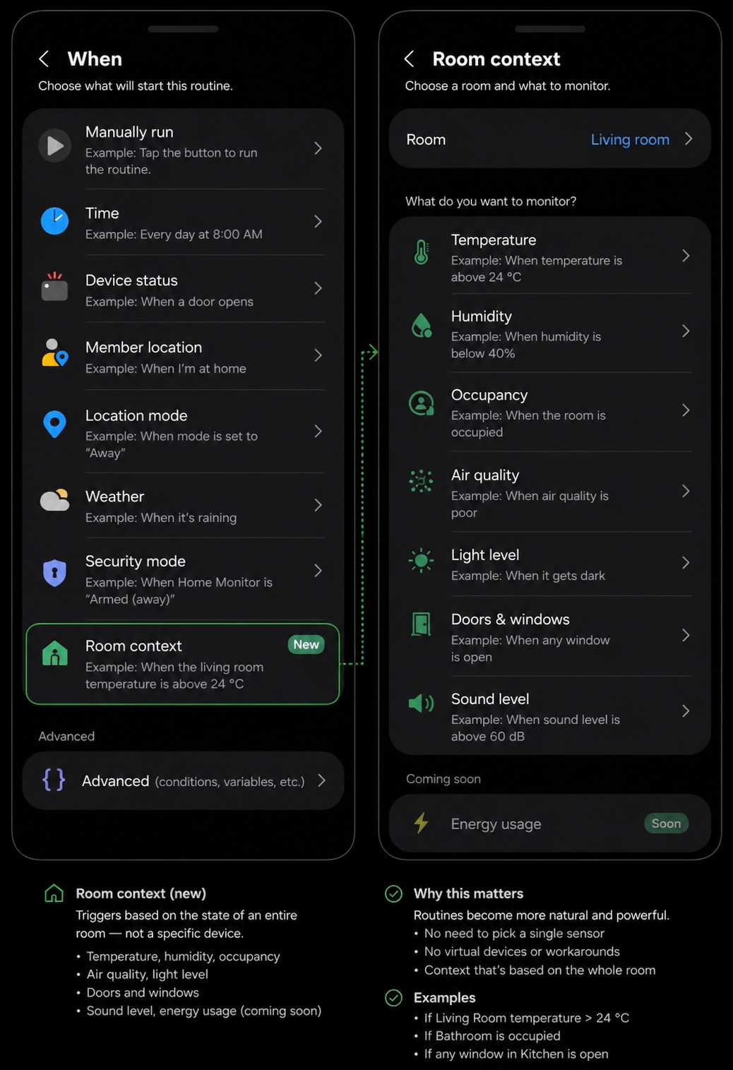

Value for Rules and Routines
Context Capabilities could become new Rule operands.
Example:
  "if": {

For the SmartThings app, these same concepts could appear as Routine conditions:
If wind gust is above 35 km/h
If Living Room is occupied
If outdoor air quality is worse than indoor air quality
If electricity price is low
If privacy mode is active
If any water leak is detected in this Location

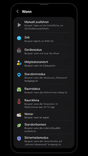

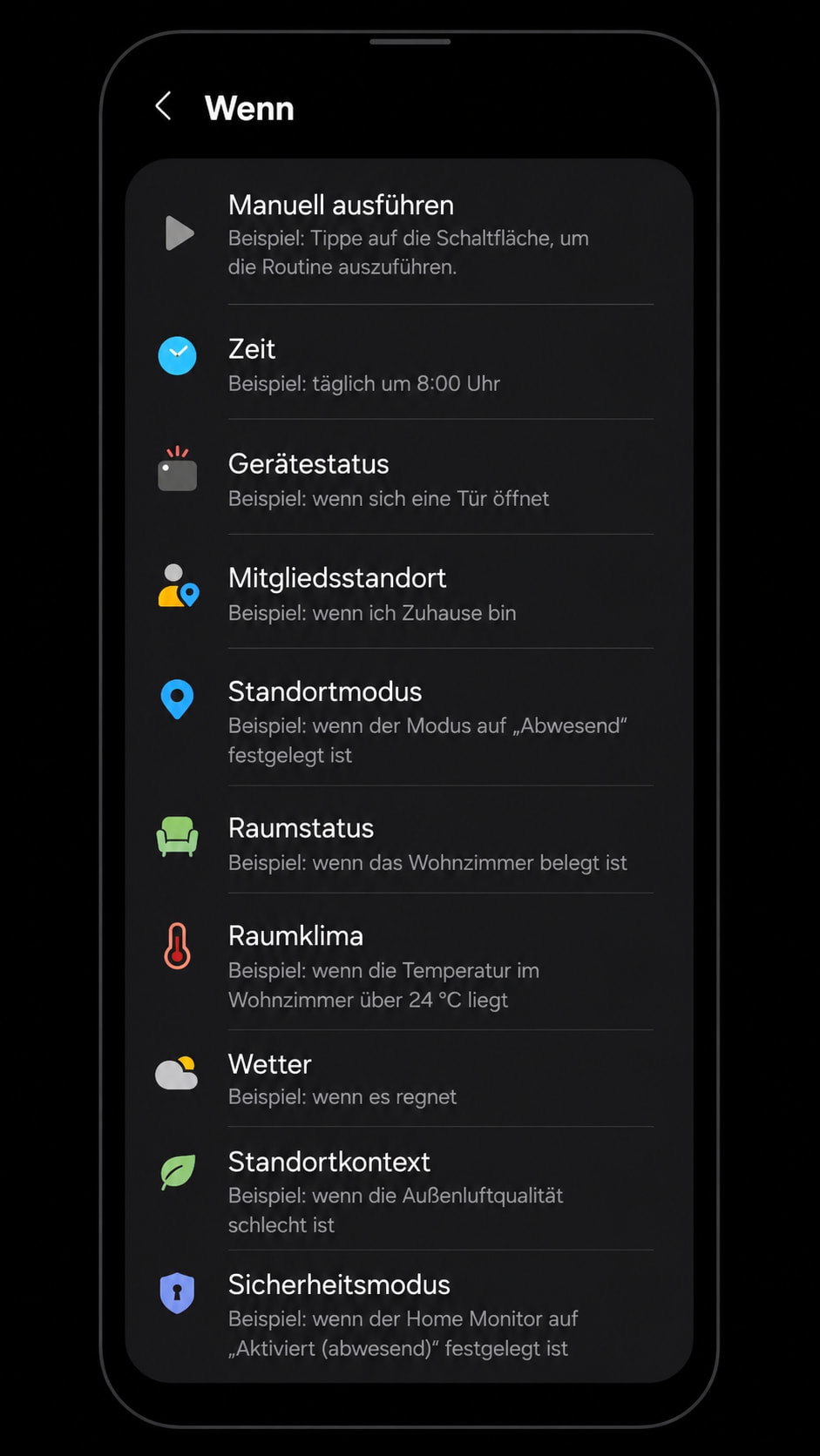

The reason I keep coming back to this idea is simple: as a SmartThings user, you eventually hit a wall.
SmartThings is very good at devices. A device has components, capabilities, attributes and commands. That part works well.
But the home itself still feels very device-centric. Locations and Rooms mostly organize devices; they do not really behave like entities with their own state.
When I create a Routine, I cannot simply say:
If Living Room temperature is above 24 °C, then …
or:
If Bathroom is occupied, then …
or:
If any window in this room is open, then …
Instead, I have to pick a specific device in that room that provides the capability I need. If there are several temperature sensors, I have to choose one. If I want an average temperature, it already starts to feel like building logic myself. If I want room occupancy, I often end up combining motion sensors, presence sensors, mmWave sensors, modes, virtual switches, or helper devices.
That is where it feels like something fundamental is missing.
We use virtual devices for things that are not really devices. We install helper drivers. We use weather proxy drivers. We build little workarounds for states that, from a user perspective, should simply belong to the Room or Location.
A Room should be able to have a temperature.
A Room should be able to have an occupancy state.
A Location should be able to have local weather, daylight, air quality, safety state, or privacy state.
So yes, the existing Client/Summary API is interesting because it shows that SmartThings already calculates some of this information for the app. But that is not the same as exposing it as a proper platform feature.
What I mean is more like:
room.livingRoom.temperature
room.livingRoom.occupancy
room.livingRoom.windows.anyOpen
location.weather.temperature
location.daylight.isDaylight
location.airQuality.aqi
Not necessarily with exactly those names, of course - just the general idea.
For normal users, this could make Routines much more natural. It would reduce the need for virtual devices, helper drivers, weather proxy drivers and complicated workaround logic. Ever tried something like IF one of the windows in this room are open … as a precondition?
SmartThings already models devices very well. I just think the next step would be to model the home around those devices just as cleanly.
Just to be clear, I do broadly agree. If I have a point it is that some of the building blocks do already exist in the API, albeit not in a particularly useful form for the community to exploit. If the information was in what I would consider to be the ‘right’ place instead of seemingly just being for the convenience of the mobile app, then what @Andreas_Roedl is suggesting would already look a lot closer.

Yes, I think that describes the current situation very well.
The interesting part is not that SmartThings has none of this. The interesting part is that some of the building blocks already seem to exist, but they are in places where they are mostly useful for the mobile app, not as a proper public platform model.
That is also why I increasingly think less in terms of individual devices and more in terms of Locations and Rooms.
Devices come and go. They get replaced, moved, reset, renamed, excluded, re-added, or substituted by another brand. But the Location remains. The Rooms remain. The living room is still the living room, even if the thermostat, motion sensor, temperature sensor, blinds, or radiator valve behind it change over time.
That is where the current model starts to feel a little strange from a user perspective.
For example, I now have several devices in the living room that expose temperature. Some are dedicated sensors, some are thermostats, some are presence sensors, and nowadays it feels like almost every device has a temperature sensor hidden somewhere. So which one is the “real” living room temperature?
Why doesn’t the SmartThings API simply offer something like an average or representative room temperature, similar to what Home Insight already seems to do visually?
The same applies to occupancy, windows, lights, humidity, air quality, and other states. As users, we often do not actually want to automate against one specific device. We want to automate against the state of the room or the home.
Sometimes I imagine what it would be like if my wife had to rebuild our entire smart home in SmartThings from scratch. She would not think in device IDs, capabilities, components, or which sensor happens to be best placed. She would simply expect to say:
Set the living room to 21 °C at 6 PM.
She would not know, and should not need to know, that an Aqara FP300 is responsible for presence detection, or that the Frient Smoke Detector happens to be the best temperature source in the bedroom, or that three different thermostats in one room need to be coordinated.
She thinks in states and desired outcomes, not in individual devices.
And honestly, that is probably how normal users think.
Of course, I understand that @Nathan_Sterner @SmartThings API survey is likely aimed strongly at B2B and partner integrations. That is also why I framed my proposal in that direction. But the user-facing benefit would be just as important.
A good example is a small manufacturer that recently launched a Matter-over-Thread radiator thermostat valve. No manufacturer cloud, no dedicated app, no ecosystem logic like Tado. Once it is connected to SmartThings, you can manually control each thermostat in the app. That is basically it.
If you have several of them in one room, you are back to controlling individual devices. There is no room-level heating logic, no representative room temperature, no awareness of open windows, no understanding of whether the room is occupied, and no real abstraction above the physical devices.
The manufacturer is essentially saying:
Here is the device. Now you figure out how to make it smart.
But this is exactly where SmartThings could provide enormous value.
What if the kind of intelligence that Tado provides through its own cloud could exist natively in SmartThings?
For that, the API would need an abstraction layer above individual devices. Something like:
If the average temperature in the living room is below X, set all radiator thermostats in that room to Y.
Or:
If any window in this room is open, pause heating in this room.
Or:
If the room is occupied and the room temperature is below the target, heat the room.
That sounds simple from a user perspective, but implementing this kind of cross-device logic in SmartThings is surprisingly difficult.
And that is where many current workarounds start to feel like Rube Goldberg machines.
Virtual switches. Helper devices. Mirrored attributes. Multiple routines just to express one logical condition. Rules copied into the Advanced Web App with IDs manually adjusted. Virtual aggregation devices just to represent something that should arguably already exist at Location or Room level.
Personally, I really dislike virtual devices for this kind of thing. I understand why they exist, and I understand why they are useful, but it feels fundamentally wrong to create a virtual switch and several routines just because I want to use a condition like:
Not all windows in this Location are closed.
That should not require a workaround.
So yes, I completely agree: the fact that /weatherdata, /summary, and /summary/presentation already exist is actually very interesting. It suggests that SmartThings already has pieces of a Location and Room context layer. But those pieces are not where they should be. They seem to be shaped around the mobile app experience instead of being exposed as a clean, documented, public API model.
What I would love to see is this idea taken seriously as a proper platform layer:
Location context
Room context
Hub context
Network context
Not as app tile data. Not as hidden Client API behavior. Not as something only advanced users can reverse-engineer.
But as a supported SmartThings API concept.
Because the missing piece is not just more device control. SmartThings already controls devices very well.
The missing piece is a clean way to describe and control the state of the home above the individual devices. An aggregation layer of capabilities, if you will.
(Source)
And I thought I was the first to come up with this idea…
Maybe you were, and Home Assistant was simply faster to implement it than Samsung? :thinking::sweat_smile::rofl:
