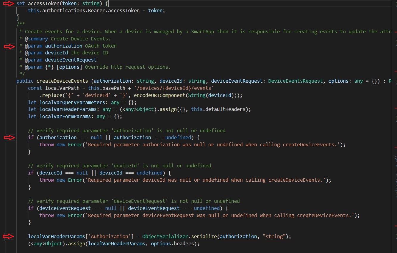

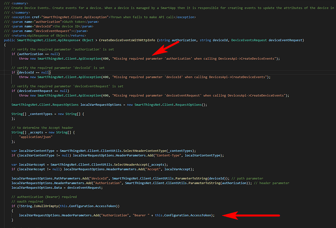

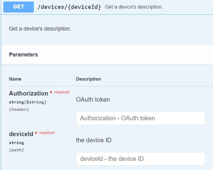

I’ve noticed in the yaml definition here: https://swagger.api.smartthings.com/public/st-api.yml
There is a problem with both the parameter ‘authorization’ and the security Bearer. The definition states the ‘authorization’ parameter to be
required: true
Since this can be set in the security Bearer token this is not the case and should be set to false.
